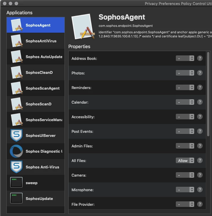

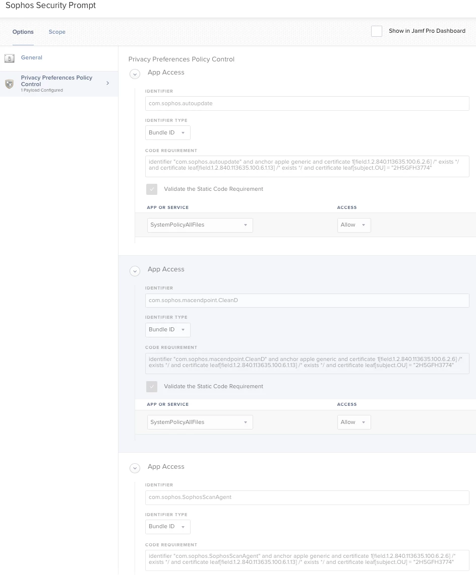

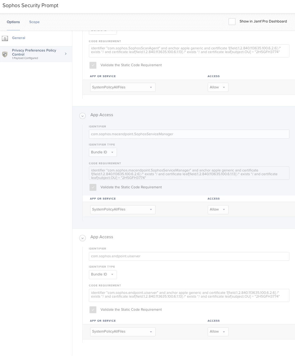

Hi Guys
Got an issue where Sophos is prompting for full disk access, we have created a profile and pushed it out to myself as a test user but I still get this pesky end result pop up.
See attached screenshots of a profile created based on KB from Sophos https://community.sophos.com/kb/en-us/134686

I dont see an entry for com.sophos.SDU4OSX in your profile
That was a new one that came in with 9.9.5 that was not on the Sophos doc in the run up to Catalinas release.

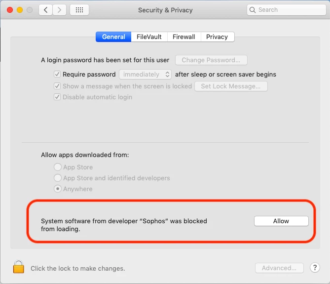

No matter how many changes I've made using articles from Sophos and from Jamf Nation, I still get the pop up that I need to allow Sophos in Security & Privacy. see below :(

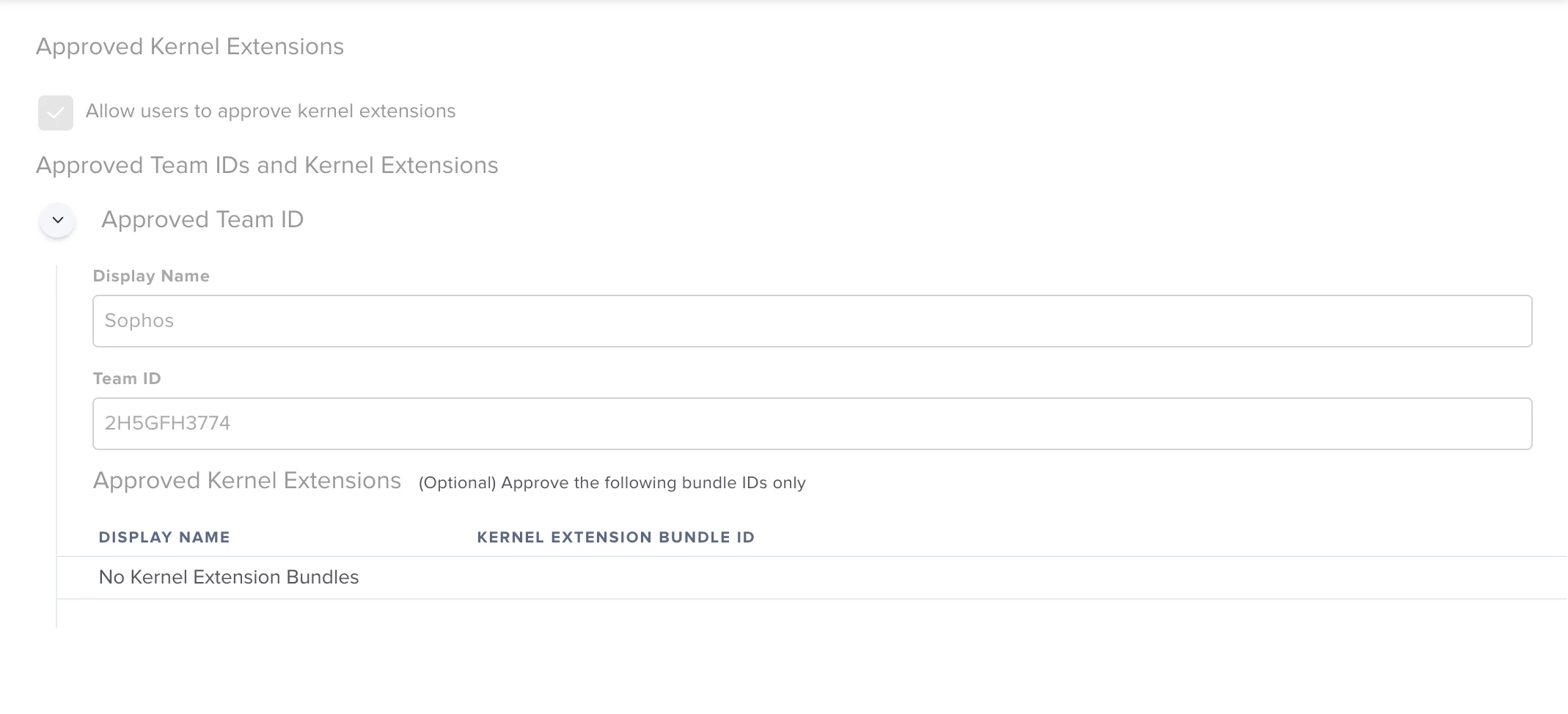

@Veronica.Lozano That message is the Sophos Kext file. Have you put in an approved Kext configuration profile that is installed before Sophos installs? We use Sophos cloud here and it works fine as long as we have the Approved Kext configuration applied along with the PPPC configuration before Sophos installs.

1. Whitelist the Kernel Extension
2. Whitelist the System Extensions
3. Create PPPC Profile
  • Whitelist The Kernel Extension
    You should be able to create a new profile to add a Kernel Extension. I didn't end up doing just the extension, I whitelisted the Team ID for Sophos (Team ID: 2H5GFH3774)
