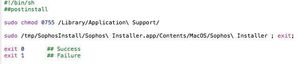

So @gazlee found that the command "sudo chmod 0755 /Library/Application Support/” can be ran without disabling the SIP and corrects the permission(s)
This was added to a .pkg file (post script) with the path to the file which runs the manual install + sorts the permissions
In terminal if this permissions command is ran and then use the silent installer one provided by sophos ..it works.
sudo /private/var/tmp/sophos/Sophos Installer.app/Contents/MacOS/Sophos Installer --install
My problem is now if these are combined into composer the sophos install/quit screen opens so is not silent - this is where Sophos did a runner..

  • March 9, 2018
Above is the full script i have within composer.
Place installer files within /tmp
create post install (shell script)
permission command and then installer

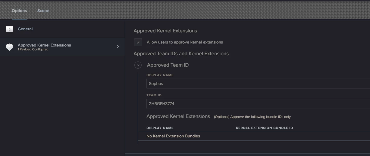

I was able to use #calvins awesome script to install Sophos 9.7.6 but I received the message System Extension Blocked. Once I went into the security settings and allowed it... Sophos appears to be running and says my computer is protected. Is there anyway to automate approving the System extension? Thanks, Ray
  • June 20, 2018
@rgerman , you need to also do a Configuration Profile that whitelists the Sophos Kernel Extension's TeamID. At a high level in general, we whitelist a ton of Kernel Extensions in a single profile scoped to all machines that have User Approved MDM enabled, including Sophos.
See this screenshot for what you need

  • June 20, 2018
@calvins Will whitelisting the Team ID do the trick or do we need to list all the bundle IDs?

Whitelisting a Team ID blesses everything that uses that same ID. So Sophos installs something like 4 kernel extensions, but you can get away just doing the Team ID they all share. That single entry in my screenshot is the only Sophos thing we have to whitelist to Endpoint work.
There's a good script in this other thread about finding these extensions and all the ID's associated with them. By @franton, here.
We run a simplified version of that on all our Macs 1x as a policy, then we just have to skim policy logs on a machine if someone needs one added to our global whitelist. We have 22 total Team IDs in there right now, but only Sophos and HP complained about needing it approved; the rest were pre-emptive.
