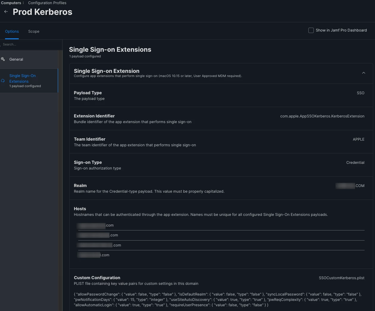

Here is our Config Profile.

Are you using Entra ID or on-prem AD? I realized the Single Sign-On Extension config you posted is set to use an SSO payload rather than a Kerberos payload, and the latter is what we're using for on-prem AD.
SMR1
  • Dec 17, 2024 8:06 PM UTC
Entra ID

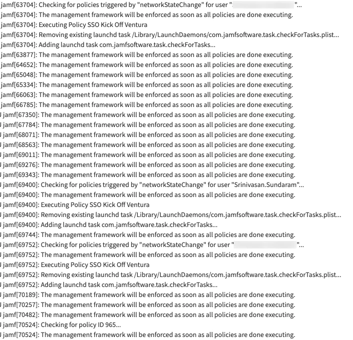

Here is part of the log I shared with Jamf last year and what they said.
Shyamsundar
  • Dec 18, 2024 7:49 AM UTC
On What trigger and frequency this policy is running, it might be the case that this policy keep on executing and doesn't allow other policies to run, Once you restart the device it Kills the JAMF Service
SMR1
  • Dec 18, 2024 1:45 PM UTC
As I mentioned above, the policy runs on a network change. The policy does it's job and reconnects the SSO, but causes an issue with the management framework. When the issue does happen, the only policy that will run is the SSO one.
