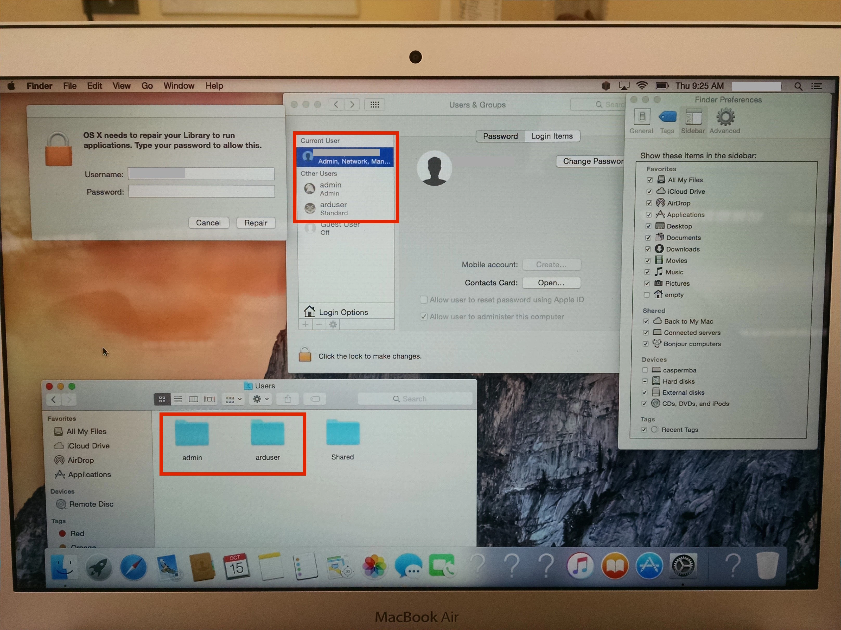

Initially based on the suggestions here, I disabled the Use UNC path setting via policy given we were getting the same error message that "User cannot be logged in at this time". However, when I tried logging in with several test AD accounts on a freshly imaged machine I kept getting an error saying that "OSX needs to repair your library to run applications".
Looking a bit closer, I noticed that while the test AD accounts were indeed logging in, a local home directory was not being created in the Users folder on the machine. In System Preferences, too, in Users & Groups, rather than seeing a Settings button for the mobile account I was logged in as, it said Create. So it appeared to not be actually creating the local mobile account. It was doing this just fine before I made this change ...
Running a dsconfigad -show in Terminal I realized that there were two pertinent settings related to home directories - one for determining the UNC path and another for actually mounting the network home folder as a sharepoint. While the UNC path is a checkbox option within Directory Bindings on the JSS, the option for mounting the network home folder as a sharepoint is not, oddly enough. So I changed this manually with a dsconfigad -sharepoint disable in Terminal.
After logging in a second time with the previously tested AD test accounts, it did not give me the "cannot be logged at this time" error, it successfully created the mobile account locally on the machine, and the Launch Agent for mounting the logged in user properly mounted the test user's network folder.
Perhaps this is not the same issue you were experiencing, but for us given my tests and results it appeared the issue was not with the UNC path per-se but when both UNC and mounting a user's home directory as a sharepoint were enabled when a user was logging on a machine for the first time.
