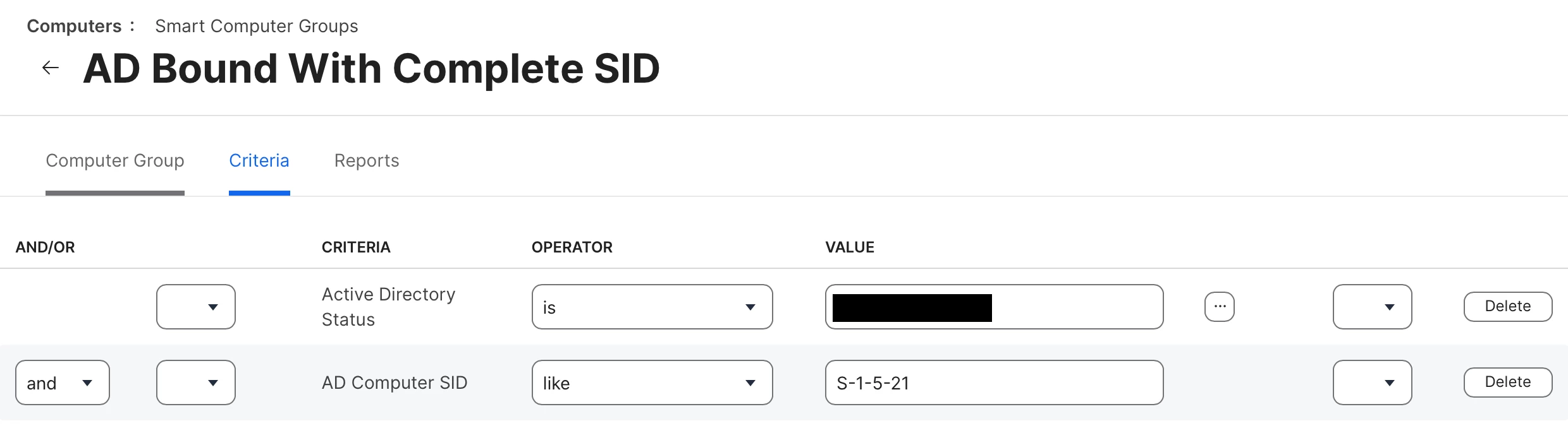

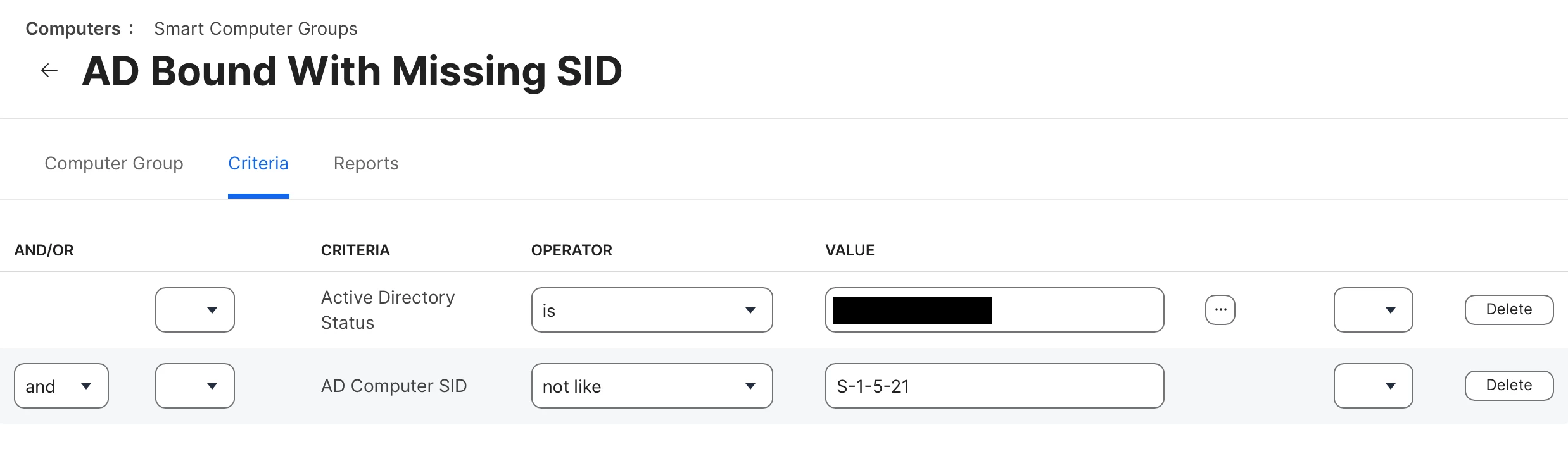

Smart group for checking computers with a missing or successful computer SID
You will want to create a smart group so you can target devices once this process is complete and possibly target the devices that may need more work or may have issues.
In this example, we are checking for devices that are bound to your active directory domain and Missing a valid SID. Based on testing the computer SID Should start “S-1-5-21” however it is recommended you check your environment.

You will need to run this script on all your Macs which require a Compter SID. This will be your smart group created with all devices missing a computer SID
As we are scoping this to a smart group. Upon successful collection the computer will fail out of the scope of the policy and the policy will no longer run. As the Computer Record will not change until wipe and re-bind, this process is only required to run once successfully per computer. The reason for running this ongoing is a computer may not be in the office or able to connect to AD Domain to read its Computer SID info, so we need to keep trying until it is successful.

Scope to Target Smart Group - AD Bound With Missing SID
