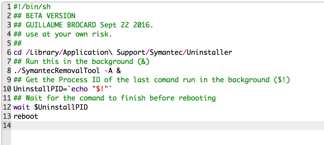

to solve this i wrote this script:
!/bin/sh
BETA VERSION
GUILLAUME BROCARD Sept 22 2016.
use at your own risk.
cd /Library/Application Support/Symantec/Uninstaller
Run this in the background (&)
./SymantecRemovalTool -A &
Get the Process ID of the last comand run in the background ($!)
UninstallPID=echo "$!"
Wait for the comand to finish before rebooting
wait $UninstallPID
reboot
This works but it is absolutely silent and will reboot your WSS with no warning (in less than 2 min)...
Please give feedback or any improvement you think are needed.
Thanks

it seems my script is not copied properly!
