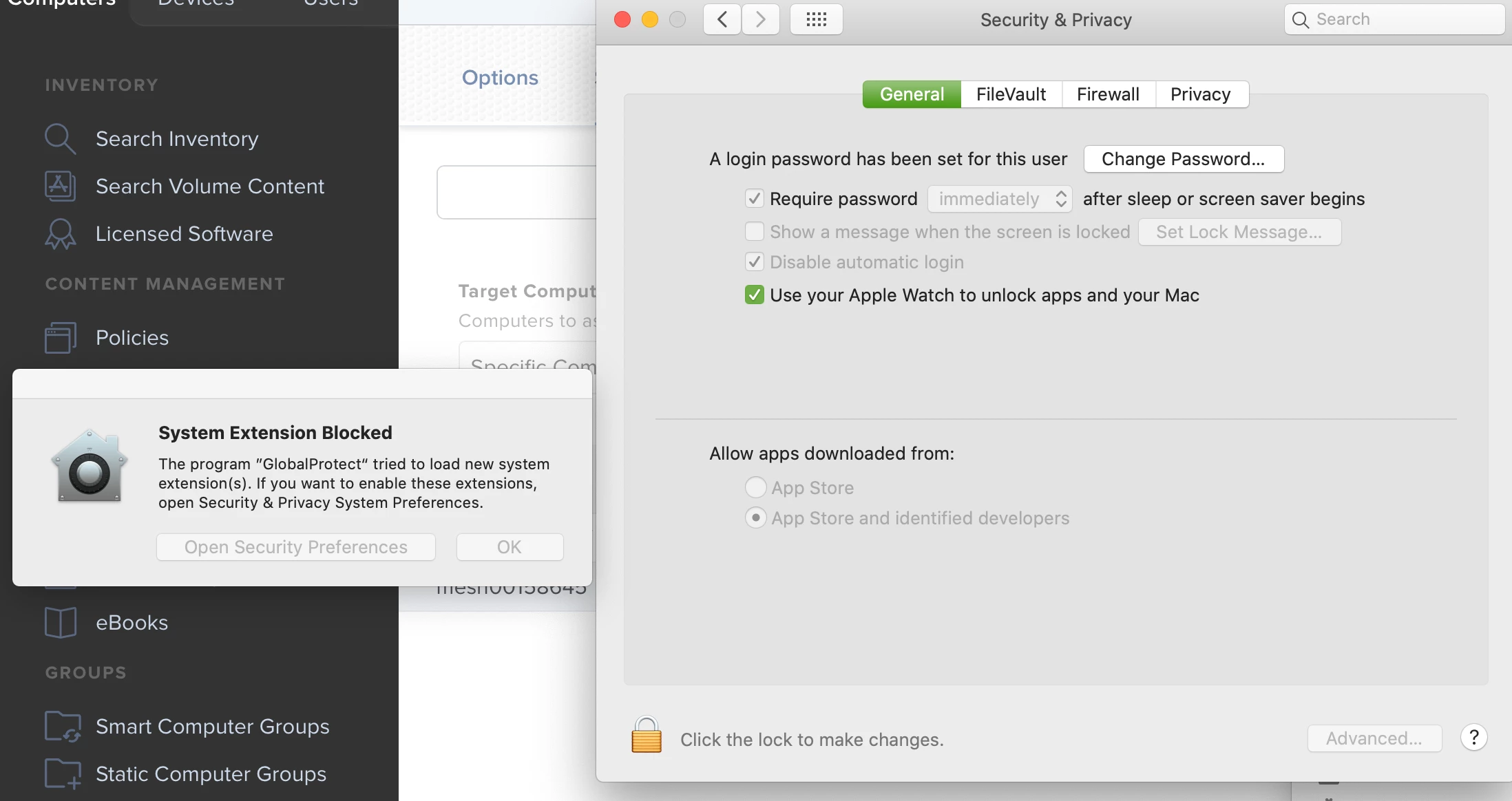

@sdagley Right, but if the set up is that you can't log into the client because the connection is needed to verify that it's you, then it's a chicken and egg situation. Meanwhile the user gets prompted with asks to allow for extensions where the buttons are not clickable and in the case of standard users they can't allow for the extension in System Prefs.
sdagley
  • Nov 10, 2020 5:58 PM UTC
@TechM If you deploy a Configuration Profile to approve the System Extension before GlobalProtect is installed then the user won't see that prompt.
TechM
  • Nov 11, 2020 6:07 PM UTC
@sdagley I should have stated that this is the behavior with all the provided config profiles provided by Palo Alto that's on the KB behind the sign-in page.
sdagley
  • Nov 11, 2020 6:27 PM UTC
@TechM Those Configuration Profiles are for enabling specific functions of the GP client that require payloads not yet directly supported as of Jamf Pro 10.25.1. You still need to create the Configuration Profile with the System Extension payload described in the Enable System and Network Extensions using jamf PRO KB article.
TechM
  • Nov 12, 2020 6:10 PM UTC
@sdagley Yep. All those are in there. I worked with PA to provide feedback for that page. However, when they were given the feedback that the UI was not allowing those buttons to be actioned, they ignored the feedback. All those payloads plus the ones that have to be configured on the customer end were not even on their radar until we encouraged them to update their documentation and separate their macOS KB from their iOS/iPadOS KBs.
In our case, clients MUST log in to their GP client before making a VPN connection. There is no way for that connection to be made without that login. How is GP going to know where to connect to if it can't even authenticate to begin with?
Or am I missing something?
sdagley
  • Nov 12, 2020 6:36 PM UTC
@TechM Are you using purely AD based logins? That's not really recommended. The more common approach is to have a local account on the Mac that is password synchronized with AD via a tool like Enterprise Connect or NoMAD (or Jamf Connect to use a Cloud IdP). That way a user can authenticate as admin on their Mac without an active network connection.
TechM
  • Nov 13, 2020 6:16 PM UTC
@sdagley Yes, this is an AD environment. We know it's not recommended and have advised the business accordingly, As for being admins, not all business have their users set as admins for lots of reasons, regardless of active network connections.
My main gripe is the UI should at least be showing the buttons in the dialog so that some sort of dismissive action can be taken and to have PA acknowledge as much.
