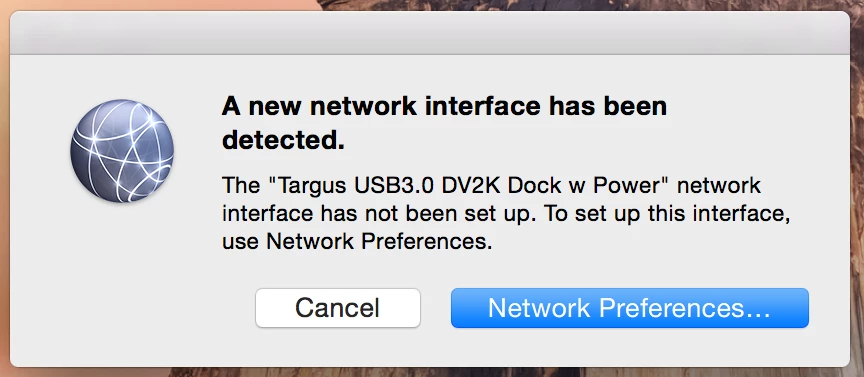

I need to allow a standard user to allow the use of and configure a new interface when plugged into the machine. These interfaces are typically created through the use of USB based docking stations. I've added an example of what a standard user is prompted with when connecting to an unfamiliar dock.
I also need to allow a standard user to create, edit and remove printers.
