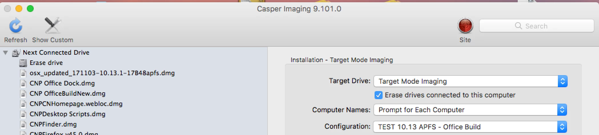

I have re-made this image using AutoDMG and still the same, I have also ensured that Erase drives is selected.

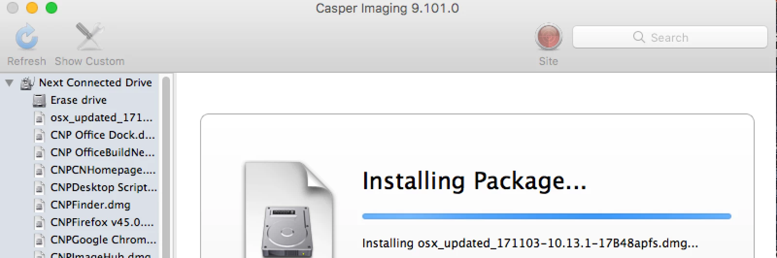

I have posted some screen grabs showing this.

Yes, the issue is it's not erasing the drive. That is apparent in the fact that in the Jamf/Casper Imaging screenshot it's displaying "Installing Package..." instead of "Block Copying..." If it's installing it, then it couldn't erase the volume. It would always block copy if the drive was reformatted.
I don't have any more to offer you on this as I don't use Jamf Imaging these days. But I also see you're using version 9.101.0, which, I think would be compatible with APFS and High Sierra systems, so I don't have an explanation.
