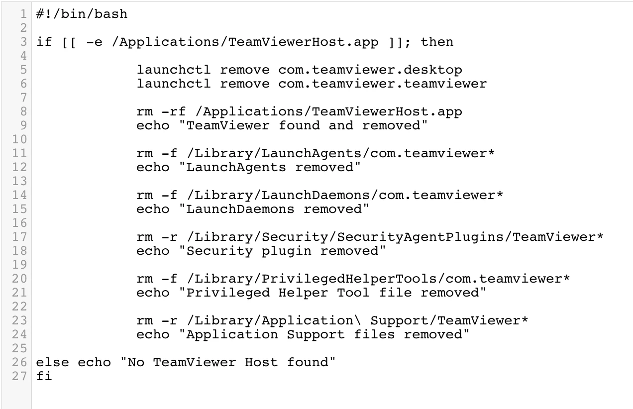

I'm looking to create a script to uninstall TeamViewer as part of user initiated enrollment into JAMF Pro.
I found this discussion here: https://www.jamf.com/jamf-nation/discussions/22216/uninstall-teamviewer-via-script-or-terminal
I have limited scripting knowledge, so I took the script from that discussion, and made some small tweaks.
The script works as designed, but deleting the security agent plugin crashes the OS on reboot and requires a format/reload. I'm curious if anybody has any insight into what's going on there.

Looks like the removal of TeamViewerAuthPlugin.bundle is leading to the issues you are facing.
Found this script in MacAdmins TeamViewer section:
# TeamViewer full uninstall, from TV support.
# Does what clicking 'Uninstall' does in TV Advanced preferences
# Quit TeamViewer
/usr/bin/osascript -e 'quit app "TeamViewer"'
# Unload TeamViewer Helper
/bin/launchctl remove com.teamviewer.Helper
# Remove app
/bin/rm -rf /Applications/TeamViewer*
# Remove helper
/bin/rm /Library/PrivilegedHelperTools/com.teamviewer.Helper
# Remove config
/bin/rm /Library/Preferences/com.teamviewer*
# Recursively remove user configs
for u in /Users/* ; do
    /bin/rm -f "$u"/Library/Preferences/com.teamviewer*
done
exit
This script omits the modification of the Authorization Database which is protected by SIP, so it is best not to modify.
