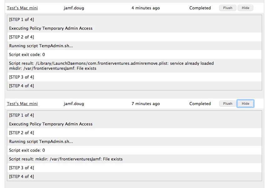

I am implementing this and can get it to work half way. It will grant the user Admin access, but does not remove it. If I run the policy the first time, it adds admin access, creates the log file and remove script as it should. I see the removeTempAdmin.sh file in Scripts. Then after the time delay (1 minute for testing) that file is removed. However Admin access remains. I have to log in as my other local admin, remove admin access from the test user account, then I can try again.
If I run the policy a second time it writes to the log file and creates the removeTempAdmin.sh script, but this time does not remove it.
This is on 10.11 if that matters.
Edit: Apparently 10.11 does matter. I used the same machine to test our 10.12 update process and now it works. However we do have users on 10.11 so curious to know why it didn't work on 10.11.
  • Nov 18, 2016 5:15 PM UTC
Another odd finding. Even on 10.12 it is hit and miss. I notice in the logs the user running the script is inconsistent. Sometimes it is the local user for the account. Other times it is the AD username.
When enrolling we have it linked to LDAP so in Self Service they are logged in as their AD account first.last. However we have not linked AD to the local user accounts. We just create those the default way using First Last, which makes the username firstlast.
For Example:
User Bob Smith has the local user account "Bob Smith". His AD account name is bob.smith. He enrolled in Jamf using bob.smith on his user account bobsmith. When this policy/script runs, sometimes it runs under bob.smith and other times under bobsmith.
This happens even if done one right after another, no login/logout of the computer or Self Service.
I'm not sure that is why it fails. Even if it runs as bob.smith the user logged is the actual local user bobsmith.
Attached is a screen shot that does show what happens when I run it multiple times. The first time it works: adds and removes admin access. The second time it adds the Admin access, but does not remove it. I see the deamon is already loaded, so perhaps thats what is happening? The deamon is loaded, so something doesn't work quire right and the removeTempAdmin.sh does not run?
