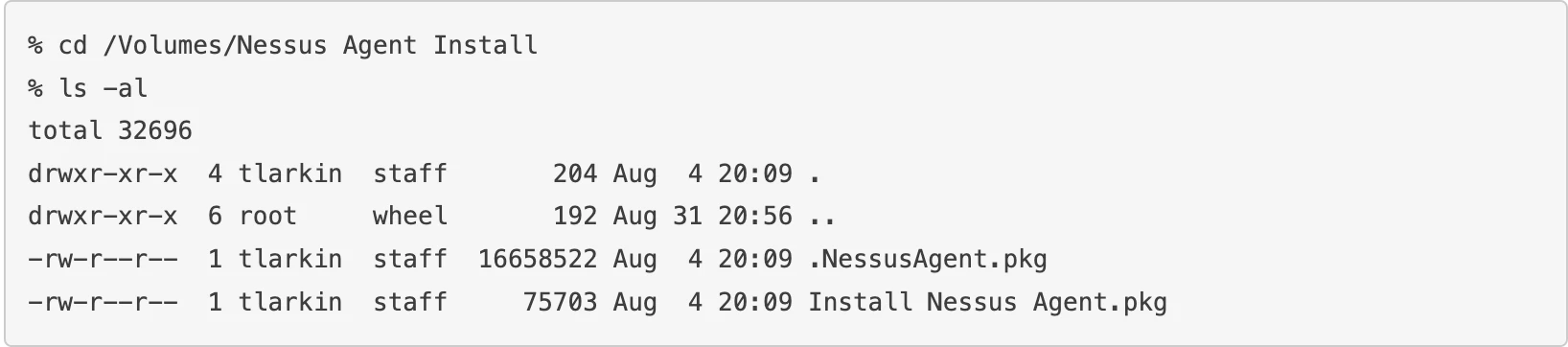

mount the installer DMG and open terminal
% cd /Volumes/Nessus Agent Install
% ls -al
total 32696
drwxr-xr-x  4 tlarkin  staff       204 Aug  4 20:09 .
drwxr-xr-x  6 root     wheel       192 Aug 31 20:56 ..
-rw-r--r--  1 tlarkin  staff  16658522 Aug  4 20:09 .NessusAgent.pkg
-rw-r--r--  1 tlarkin  staff     75703 Aug  4 20:09 Install Nessus Agent.pkg
See the .NessusAgent.pkg? That is the actual installer. Now we can cp the pkg to the Desktop or whatever and then mv it to rename it. Remember, all . files are invisible to the Finder
cp .NessusAgent.pkg ~/Desktop && mv ~/Desktop/.NessusAgent.pkg ~/Desktop/NessusAgent.pkg
