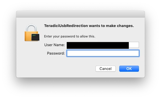

I am not having a problem deploying the .app, I basically have a policy to place PCoIPClient.app in /tmp and then copy the .app into the /Applications folder. PCoIPClient.app launches, but after quitting, I get this (see the attached .png):
TeradiciUSBRedirection wants to make changes.

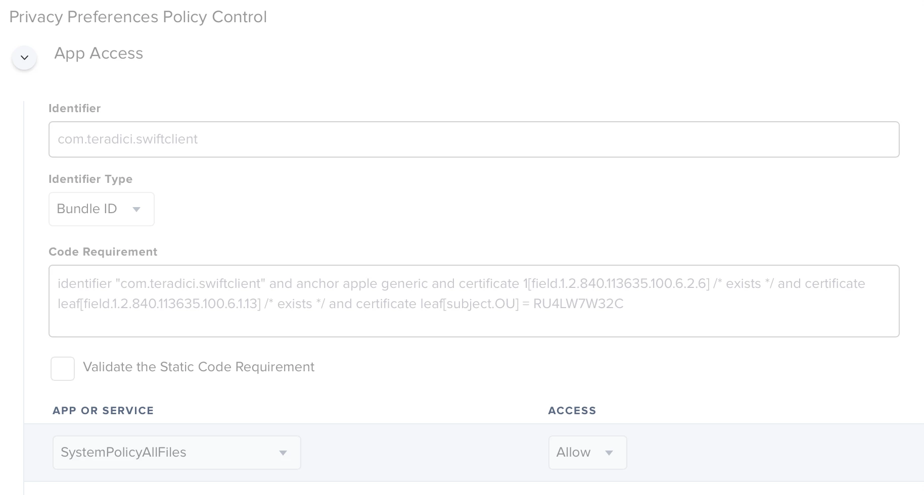

So here's what I get dragging PCoIPClient.app into PPPC Utility:
com.teradici.swiftclient identifier "com.teradici.swiftclient" and anchor apple generic and certificate 1[field.1.2.840.113635.100.6.2.6] / exists / and certificate leaf[field.1.2.840.113635.100.6.1.13] / exists / and certificate leaf[subject.OU] = RU4LW7W32C

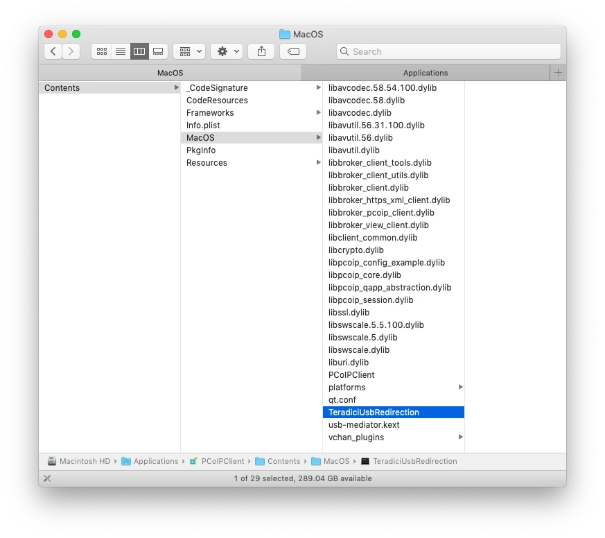

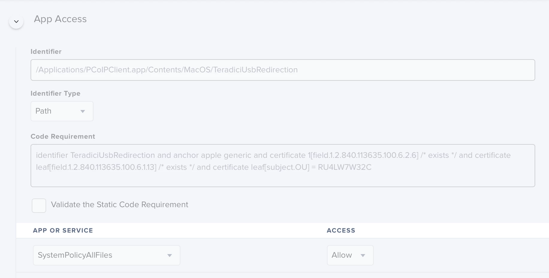

So that TeradiciUsbRedirection exists here:
I have made a profile with the above information from the PPPC Utility, but it seems I get the same behavior with TeradiciUsbRedirection requesting administrator access to do something.
