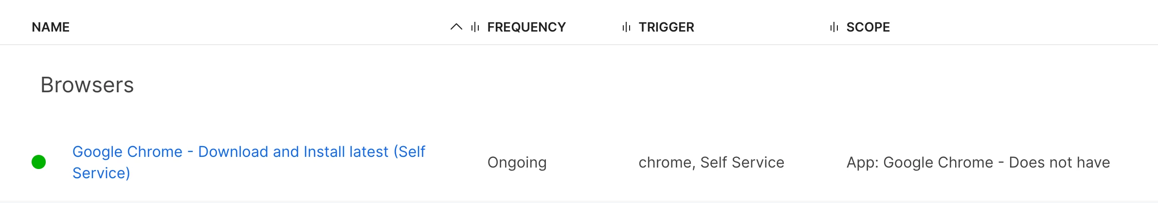

You could add a second trigger to the same policy with a custom trigger name to execute. At that point, you would run
sudo jamf policy -event “mypolicyname”
and it would execute the same policy, which could also keep your logs organized if you’re trying to track log execution as well. In your policy editor, Under General > Trigger > Custom and give it a trigger word/phrase. Was this policy cloned from another policy? I’ve seen weird things like that happen and once a new policy is created from scratch things seem to magically work as expected.
