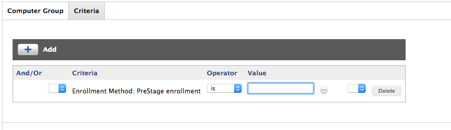

You can make a smart group based on the Pre-stage enrollment used. Then create a policy that is scoped those machines. If you have that policy run a custom trigger you could have one fleet run all of the 'deploy1' custom triggers and another that runs 'deploy2' custom triggers and have them setup like that. I currently do that same kind of setup for our DEP machines. Smart group the enrollment prestage method and then have a main Policy that kicks off the custom trigger to install all of the individual policies for DEP machines. Name your Policies with numbers so they run in order. i.e. '00 - Install Chrome' '01 - Install Office' etc. If they all have the ongoing frequency and the custom trigger set, they will run in order when the custom trigger is called.

Yeah - I was trying to avoid having two enrollment policies, but I don't think I have a choice. Most likely I will just fire off all the policies, regardless of deploy type (from one enrollment policy) and use the smart group to ignore the ones based on prestage enrollment type. It would be nice if you could plant something on the box during prestage enrollment and test for it.
