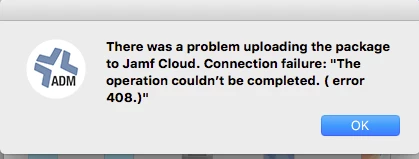

I'm attempting to upload a package (MS word update 15.37) to jamf cloud via Casper Admin 9.100.0. It gets to the end and generates the following;
There was a problem uploading the package to JAMF Cloud. Connection failure: "The operation couldn't be completed. ( error 408.)"
I get this overtime on this package. I've redownloaded it, deleted it in JSS. Attempted through JSS to upload it. I'm at a loss.

I don't have a fix, but I can offer a "me, too."
Except for the fact that I'm trying to upload Outlook, not Word, I get the exact same error.
In fact, I found your message because I searched google for this:
There was a problem uploading the package to JAMF Cloud. Connection failure: "The operation couldn’t be completed. ( error 408.)"

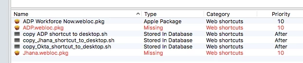

Known issue PI-004504: Admin will fail to upload anything if it takes longer than 80 seconds to upload.
To understand how this works, you first have to understand that two things happen when you upload a package:
  1. The package file gets uploaded to a file server, and
  2. An entry for that file gets created in the JSS database.
When you encounter this bug in Jamf Admin, the upload fails, but the database gets updated as if the upload had succeeded.
If you use JSS to view packages, everything looks normal. But if you use Admin, they show up as listed, but missing, like this:
If you try and upload again, you'll get an error indicating that a package with that name already exists (because the database thinks the upload succeeded).
To fix such a failure, you have two options:
1. Rename your local copy (e.g. "Sierra-2.pkg"), then upload it using JSS (not Admin).
2. Delete it from JSS, then then upload it again using JSS (not Admin).
The moral of the story: Don't even bother launching Jamf Admin until this bug gets fixed.
(I had an open ticket for over a month on this before the 3rd or 4th Jamf support person found that bug report.)

This is the error when trying to upload a file in jamf admin.
