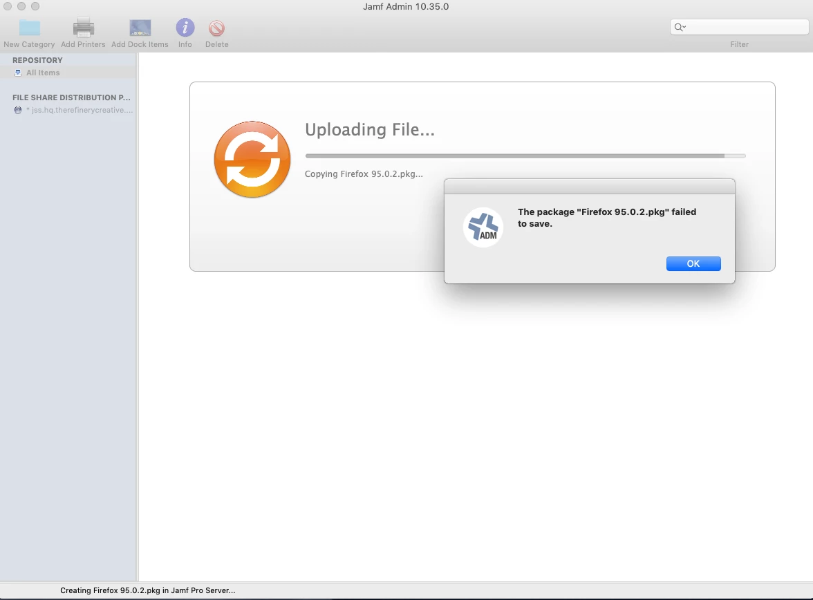

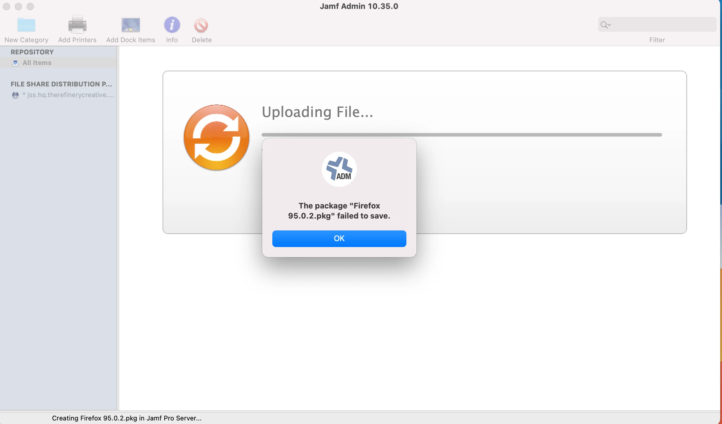

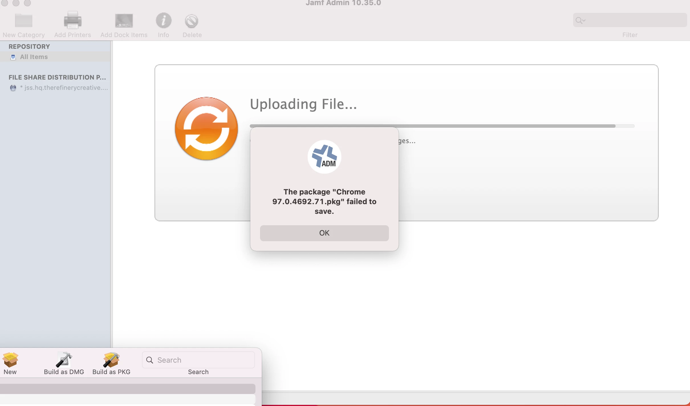

What type of distribution point is this? From what you wrote, it sounds like you are running Jamf Pro on a Mac. I vaguely remember getting a similar error when I used to run Jamf Pro from a Mac. Could you provide a screenshot of the error?
  • January 7, 2022
 these are screenshots using two different VMs as a test.  two were from Big Sur and the other Mojave.

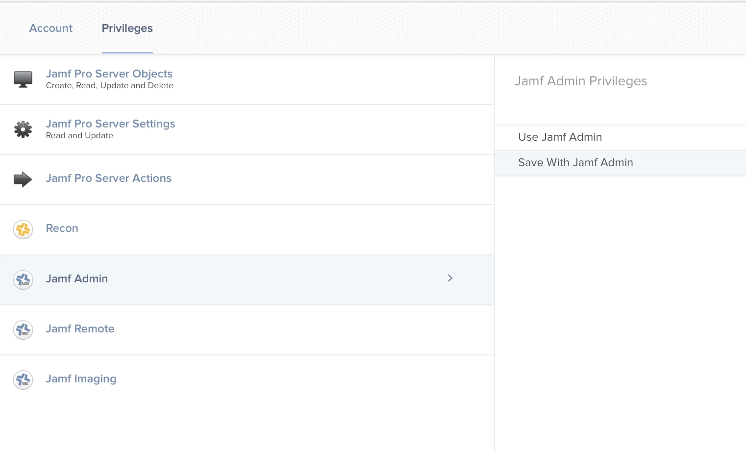

I wonder if this is a Jamf Pro privileges issue with the user account that is logged into Jamf Admin. The user you're logging in with needs to have "Use Jamf Admin" and "Save With Jamf Admin" privileges. Is this a totally new Jamf Pro server you're working with?
  • January 7, 2022
It is not new at all.  has been around for a while.  I do have a second login that I will try as a test.  Thanks for all of the great ideas!
