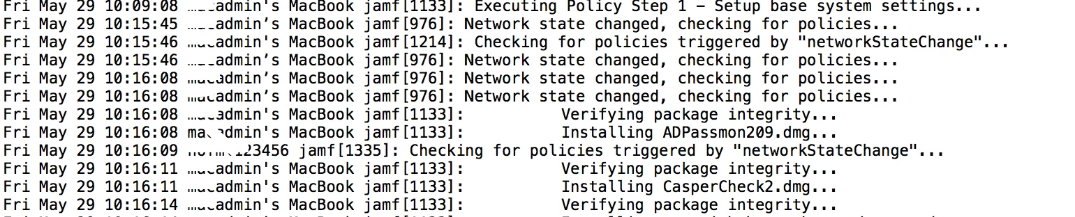

got another weird problem, relating to the naming script. It seems like the policy runs, I see in the logs that it switches the name (the log line switches to the new name, but then it switches right back and ends up trying to bind the xyz's macbook.
Not exactly sure what you mean. Does the machine switch back to the old name in terminal? Can you try running the script offline (without network connectivity)?
it starts out as admins's macbook pro due to the setup wizard
from there I launch the Self Service policy to kick off the corprification process
after a few steps you see the machine name change on the line checking for policies by "networkStateChange"
then back to the admin's macbook
Terminal shows the right machine name, but i checked Directory Binding, and it shows the admins Macbook.
so I guess I need to move the binding to later in the process (?)
Yes, I believe so... If you run the script locally without any network connection, it should change the name. If that doesn't stick once the machine re-connects with your servers, then they are most-likely not setup to accept dynamic changes from apple clients.
The host name in the logs may not update immediately. But if it's binding with the incorrect name after you've set the 3x names prior with scutil something is a miss.
Ensure you don't do what I did recently. If you are using a config profile to manage loginwindow settings, check that you haven't inadvertently checked. "Set computer name to computer record name".
I spent hours troubleshooting why my naming script wasn't working, and that option prevents you from changing it! Derp!
