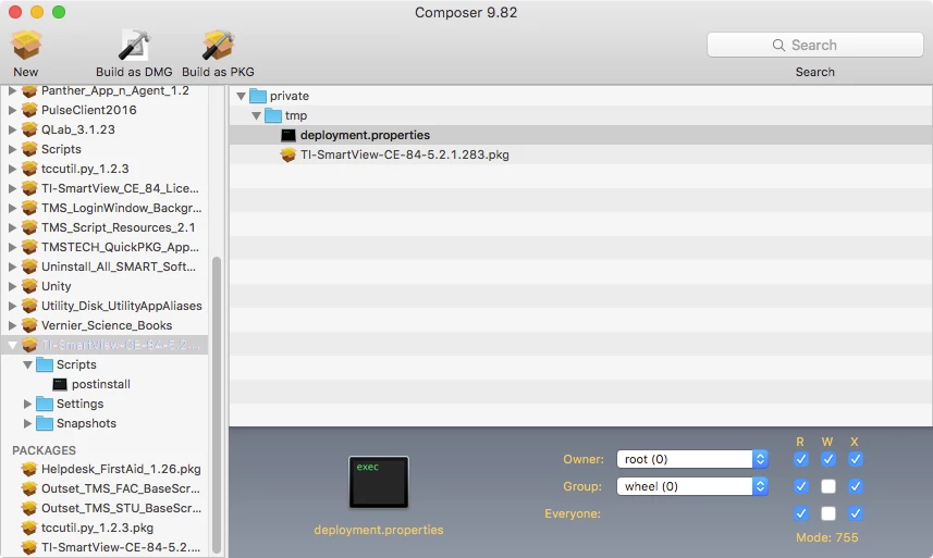

The Solution
Rather than copy the deployment.properties file to the JSS's default copy and install location /Library/Application Support/JAMF/Downloads and remove it afterward, I created a PKG installer in Composer and put both the standard TI-SmartView CE install PKG and the deployment.properties file in /private/tmp/
I created a postinstall script to log the install and remove both files afterward.
