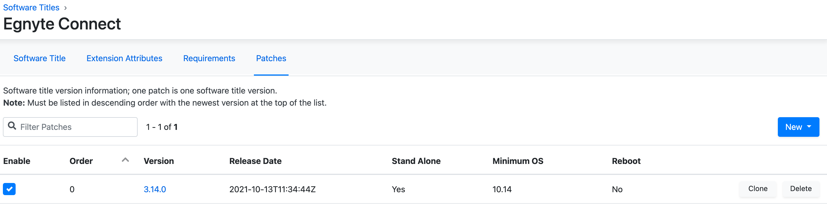

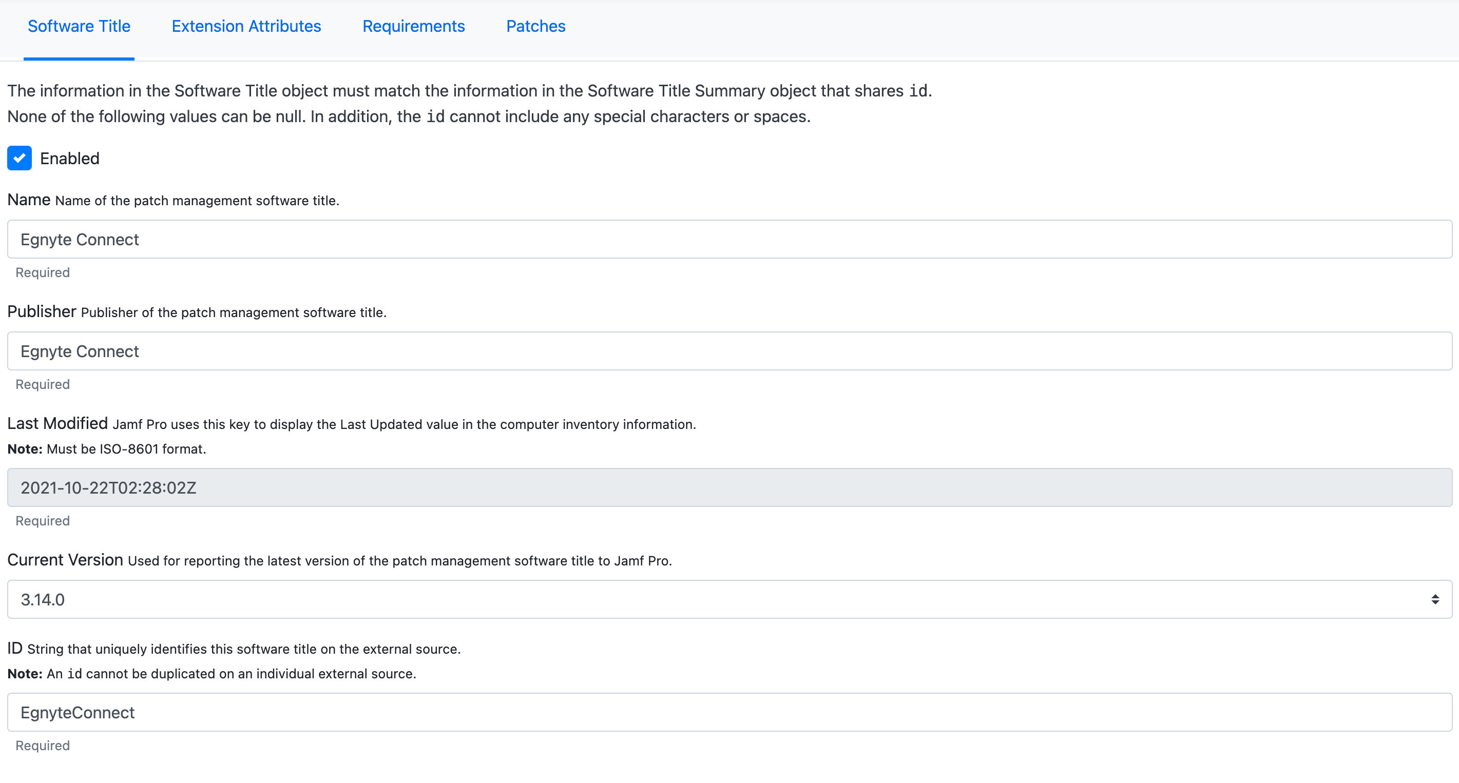

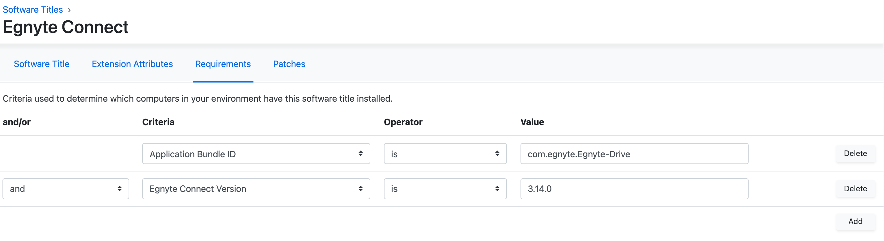

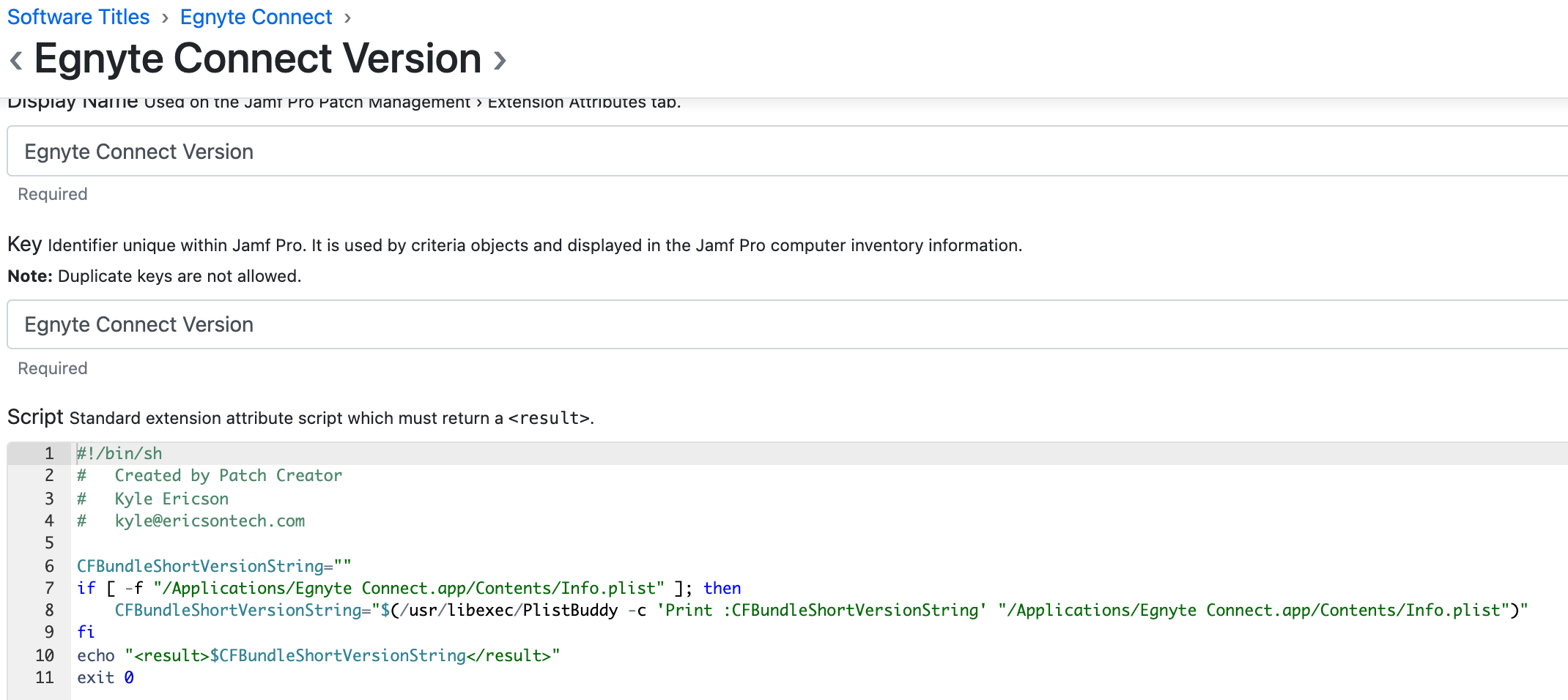

I created a custom patch title for Egnyte Connect, but for some reason, it still won't pull info to start patching. I have checked Macs and the custom extension attribute has run and gotten a value for a few Macs.
