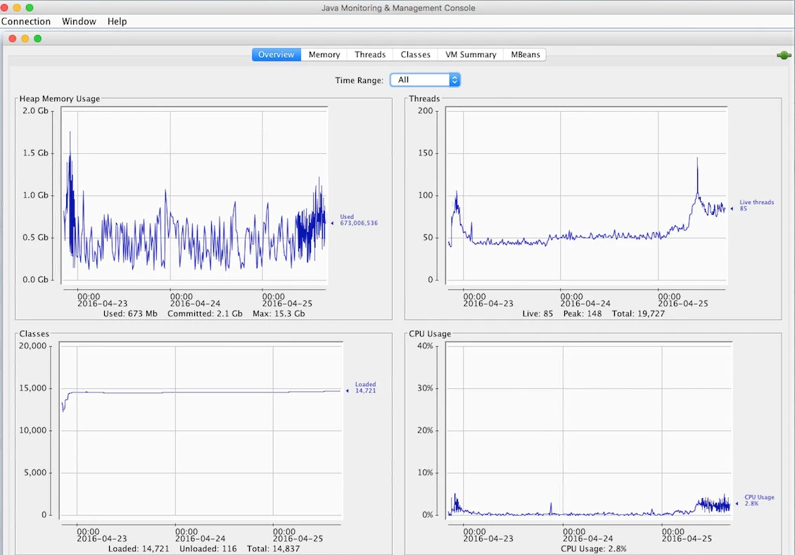

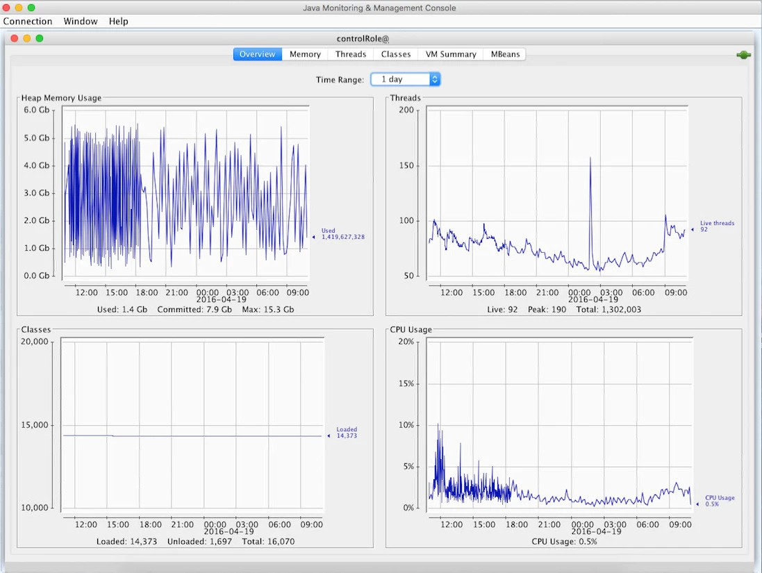

We had similar issues in the past (maybe once per year...), and most of them were happening only few day after we upgraded JSS to new version or so... Being tired of this, we have configured JMX monitoring for the JSS Tomcat instance (with "controlRole"), and now start "jconsole" during few days before and after an upgrade, to see how trends change over the time.
I attached a graph after we upgraded to 9.91, and the load we saw on server shortly after bringing it back online (before midnight 23rd), and the load on monday morning when people go to office (spike at 150 threads). The other graph with 9.73 looks very different (the one from 19th April) : here we saw permanent spikes to 6GB of memory heap all the time, but no idea why shape of curve changed so drastically... The spike at 2.00am (CET) to 160 threads, is when we do our nightly DB backup, so if you believe your thread limit is maybe 100 during the day and configured it in the server.xml, take also into account when a DB backup is made...
Unfortunately, as we didn't experienced any hang problem since maybe 1 or 2 years, I don't have anymore reference graphs where Tomcat hanged for real. However, we noticed during one Tomcat freeze, that SQL connections went to up to our configured limit : more than 500 connections, while maximum value we have seen in production is under 200 (usually the number is approx 40/50 during few months) : this probably means sth entered in a kind of loop, as MySQLd was perfectly still running...

So do not underestimate the amount of heap RAM you need for Java Xmx variable, or thread limit, as it is difficult to catch such short-living spikes...especially when they drastically change from version to version.
