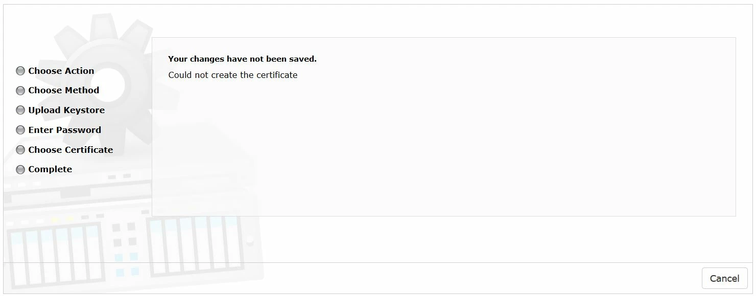

Here is where I'm stuck at now. @MTurnerFMRCO / @were.wulff / @allanp81
I got the .cem back from the CA (after giving them the .csr). We use AlphaSSL as a company. I had to inject the root & intermediate certificate into the .jks file (it was not happy with just the root). Then took that and combined it with the .cem from the CA. All commands from terminal said it worked for each step and was happy.
I then take that .jks file and try to upload it to Tomcat on the JSS URL. I choose HTTPS -> 3rd party -> upload file -> enter password -> it then says to choose the type of certificate, "Tomcat" "intermediate" or "root"
None of the above options work, I always get the following error:
I've edited the server.xml file for Tomcat on the server to match the instructions from the above link. https://www.jamf.com/jamf-nation/articles/115/enabling-ssl-on-tomcat-with-a-public-certificate
I'm not sure why it will not accept the .jks file on the webportal. I'm at a loss.
Any ideas/experience with this?

  • Jun 19, 2017 8:47 PM UTC
@were.wulff
I've tried uploading the root and intermediate cer file to the .jks. Said it was successful. Took that .jks file and tried JSS no go. Then tried a file where I combined the root and intermediate, same thing, didn't work
I was following the instructions: https://www.alphassl.com/support/install-root/tomcat.html
On the one you provided, the first two steps do not match. Root shows being injected into the .jks, however the second step is not intermediate. It is not happy without the intermediate file. Also the last step for the server.xml, I've tried comparing what the document has to what is in the file, no where in it is anything remotely similar (looked for Connector Classname, factory classname etc) since it does not exist, not sure if I need to manually enter it or not.
