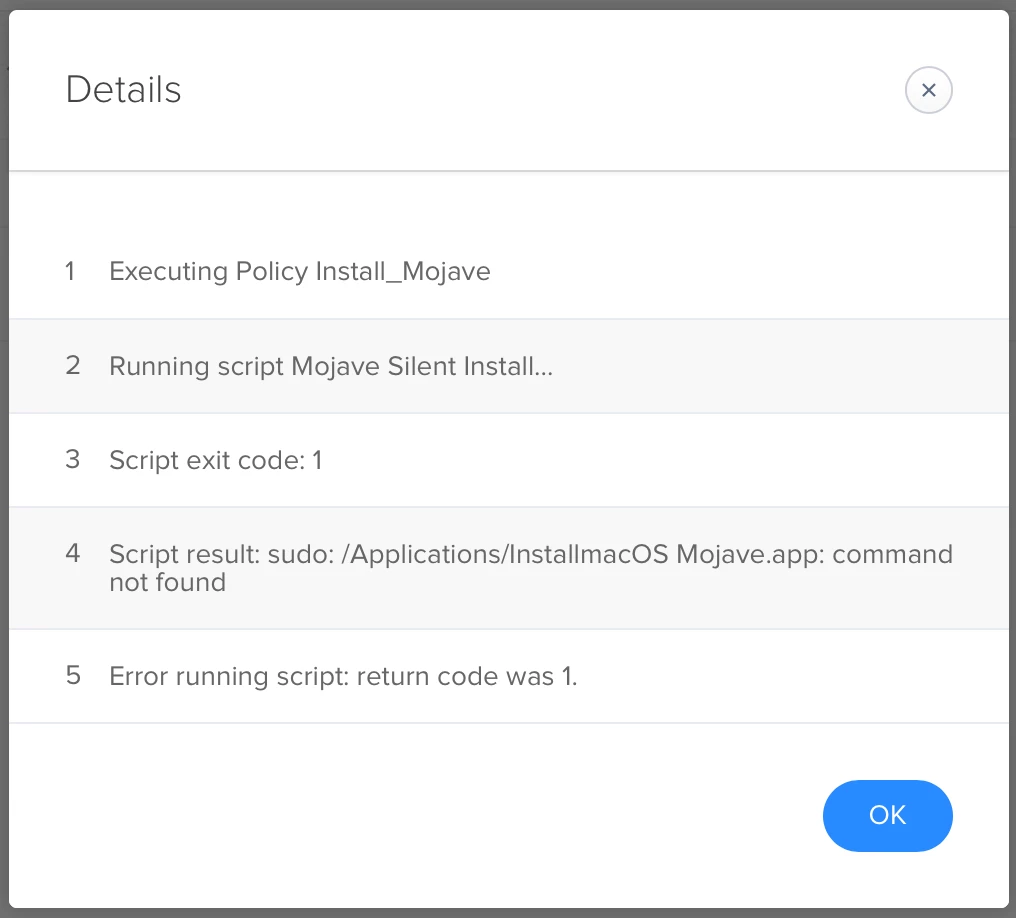

Good morning! Hope you had a great Christmas. I set up the policy/script. However I get error code when running. It states "Error running script: return code was 1". Any advice?

@achristoforatos can you take a screenshot of the policy history log expanded, also what operating system version number is the computer on that you're upgrading?
The computer is currently on Mojave and I was trying to test that it would run. Could that be the issue?
Hugonaut
Forum|alt.badge.img+15
  • December 26, 2018
drop the sudo and try it, if it's on mojave that is an issue, are you trying to totally wipe the device and reinstall oem mojave? if so the following command works on machines that are currently mojave but wipes the machine to oem
