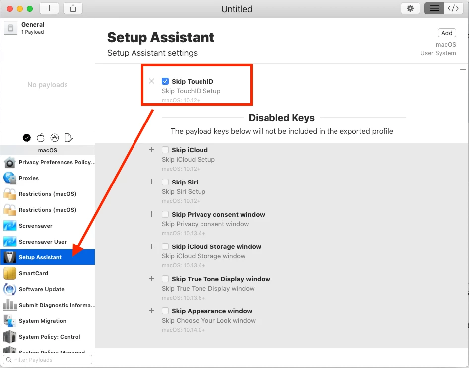

@Mauler @blochcw If you're just disabling Touch ID with a restrictions profile, you'll also want to skip the Setup Assistant screen that prompts a user to enroll in Touch ID.
For new DEP enrollments, this would be covered by skipping the Touch ID screen in your PreStage. You can also create a custom configuration profile with something like ProfileCreator, and then upload that to Jamf to disable the Touch ID enrollment screen from appearing after a future software update.

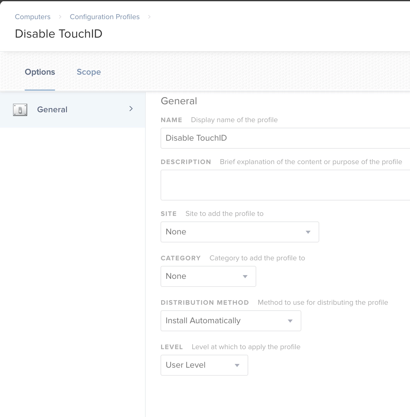

Thanks for replying! I tried making a profile with the Skip TouchID payload but for some reason when uploading it to JAMF, there isn't any payload. Pretty much any time a new user logs into a lab MacBook with a touchID, the users get prompted that TouchID setup failed. I've also tried bioutil -w -f 0 -s with no luck.

@Mauler for custom profiles, it's expected behavior to not see any payload info in the Jamf interface. If you push the profile you made to a test machine, and then sign in as a new account for the first time are you still seeing the Touch ID enrollment screen?
