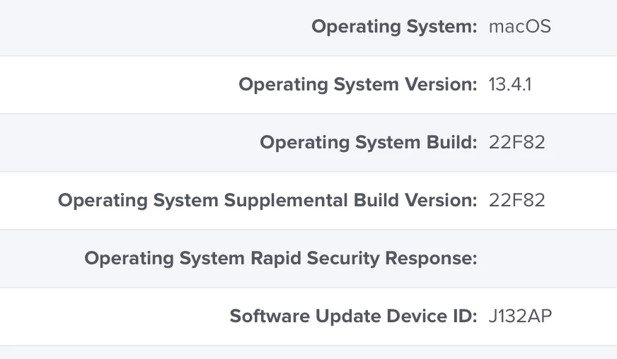

rpayne
How are y'all tracking and deploying these ever more frequent updates? For point releases we use Nudge, but have not found a way to do so for rapid security responses. Also, the following is not populating. we are on jamf pro release 10.47.0 in a cloud hosted environment. I had thought that this would be reported starting in 10.46 with declarative management (which is enabled).

Also @rpayne the updates were pulled so maybe that's why you're not seeing them? I did install on my test boxes and did a recon. The (a) showed up fine on 10.47 cloud.
Is there a way to setup automation for installation of these patches as they come out through Jamf?  Has anyone played with this yet?  I also did notice that in the main inventory screen all macOS devices show up as 13.4.1 only but not the applied security patch. I did have to go into each device OS selection to confirm that it has installed the (a) patch.  Any input on how to setup automation / management for these patches would be greatly appreciated.
rpayne
  • Jul 11, 2023 3:16 PM UTC
We use teh same Smart Group criteria.
They were pulled? I wonder why?
rpayne
This is what I'm asking.

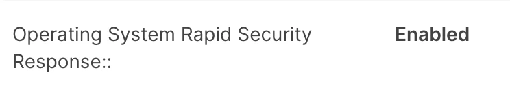

  • Jun 16, 2025 4:20 PM UTC
To enable Operating System Rapid Security Response and ensure it appears in the General pane, I implemented the following:
  • Created an Extension Attribute to report whether the feature is currently enabled.
  • Developed a script that verifies if the feature is active, checks for available Rapid Security Response updates, and indicates whether a restart is required.
  • Created a final script that programmatically enables the feature on the device.
