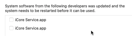

Recently we have been getting Trend needing Icore Service.app checked in the Sec&Priv > General tab.  How do we automate this?  We have the config profiles set but this still insists on manual interaction.

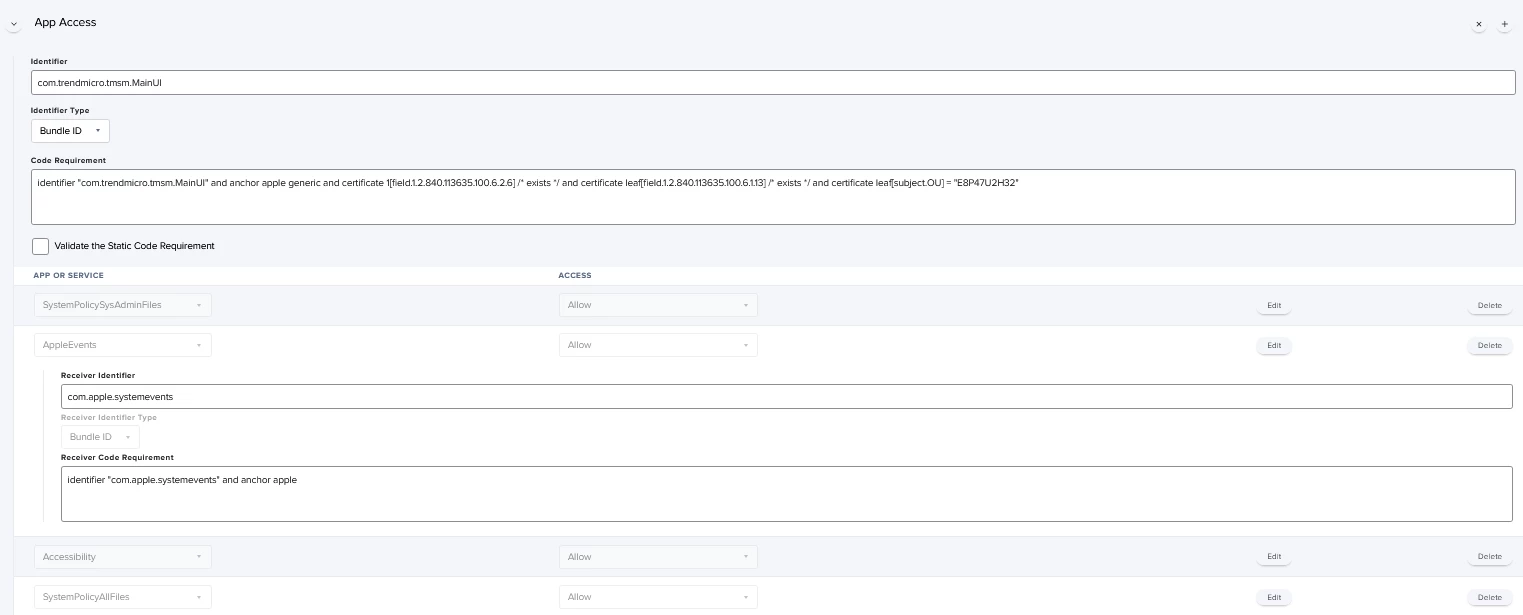

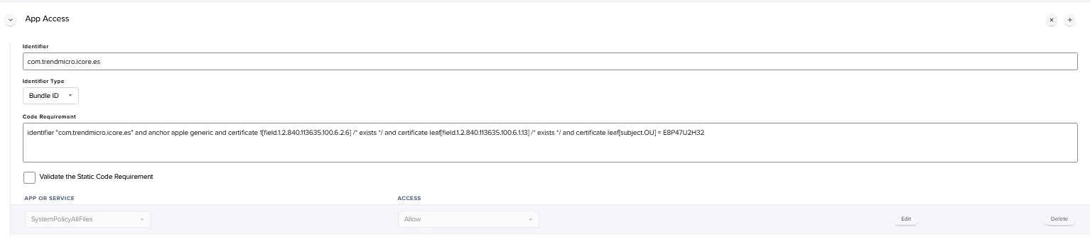

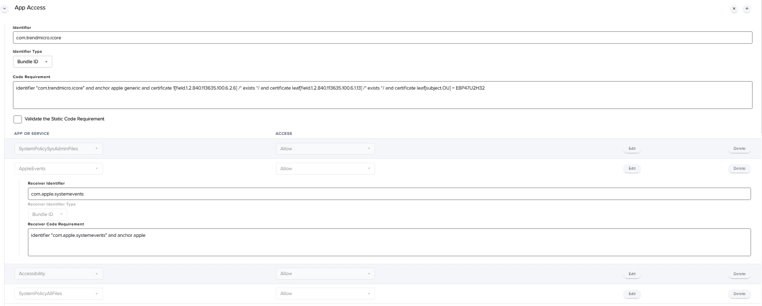

I have three privacy profile settings. Two are based off of the Trend documentation, and the last one is based off the prompt from the application to give the extension full disk access (which is not in their documentation).

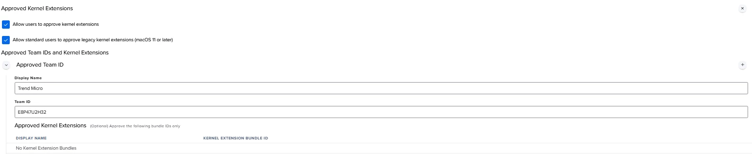

Next, I have a Kernel Extension payload. I did not specify the Bundle IDs, but you probably could (in Trend's documentation).

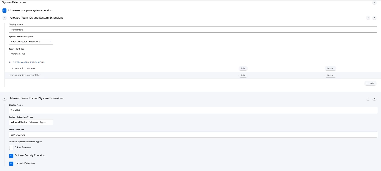

Next is a System Extension payload. This is also not in Trend's documentation, but will suppress the "iCoreService would like to filter network content" message.

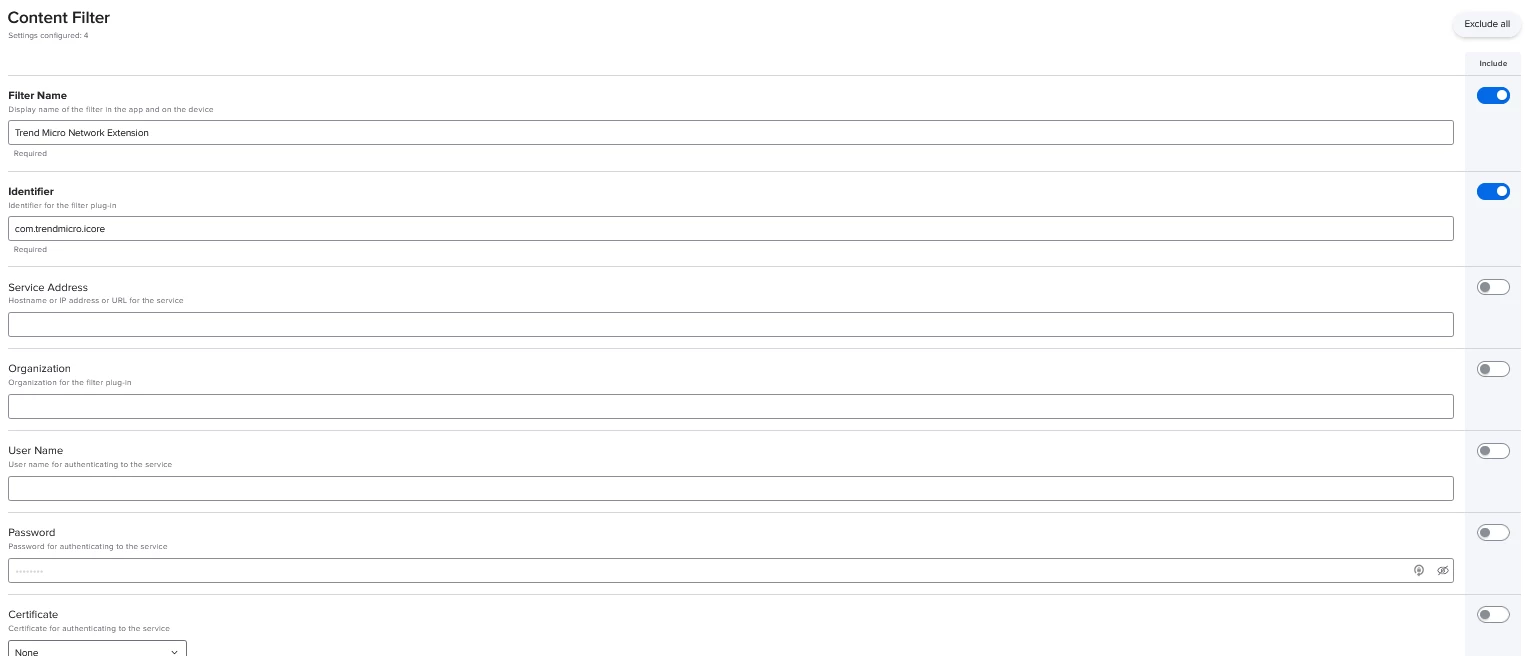

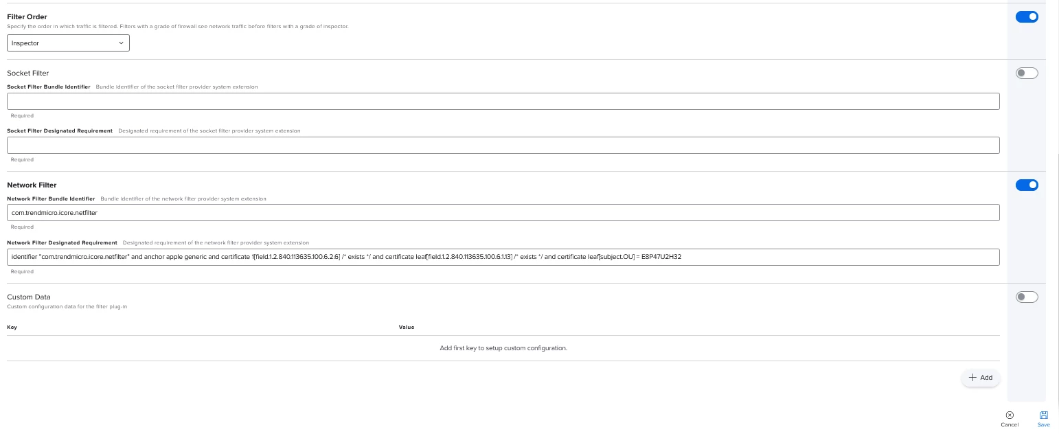

Even with this system extension, after Trend starts up, there will be an additional "iCoreService would like to filter network content" message. To suppress that, I had to create a content filter payload. Full disclosure - I am not sure if the Filter Order should be Inspector or Firewall. I went with Inspector as that is what another application we use uses (CrowdStrike).
With all these pieces together, I no longer get any Apple prompts. On Big Sur, Trend will still prompt to approve the system extension (even though it's already approved). When the user opens system preferences, they will get a message that they need to reboot (new behavior with Big Sur that reboots are required for system extensions). After a reboot everything should be fine without any additional prompts.
Thank you @mnickels! Your recipe still works like magic with version 3.5.5855 on macOS 12.3 Monterey. The 'Content Filter' trick does the job just fine to ditch the annoying 'network content filter' pop-up message.
About PPPC App Access for 'com.trendmicro.tmsm.MainUI' and 'com.trendmicro.icore', I just allowed 'SystemPolicyAllFiles' as recommended in the official Trend Micro documentation and everything appears to work just fine, without any 'full disk access' prompt so far. Was there another specific reason to allow 'Accessibility' and 'AppleEvents' to them that I'm not aware of?
