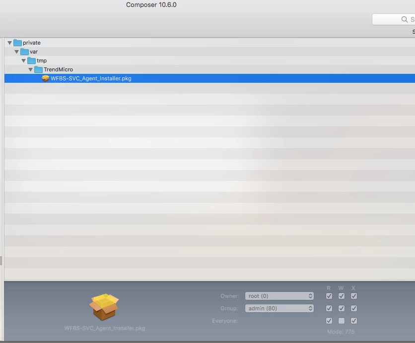

@mack525 Man this is perfect but I am using Composer 10.11.0 when I download the WFBS installer and I open Composer how do I create the .dmg file without the snapshot I would have to create a snapshot first to accomplish this correct?
  • April 18, 2019
@CorpIT_eB Yes. You can run a snapshot and then modify it.
  • April 18, 2019
@mack525 I am apologize man can you give me a bit of clarity on how you got your results on step one.
On my end when I open composer (using snapshot) I take the installer and drop into /var/tmp/TrendMicro (had to create this folder) from there I ran the installer and then capture but when it comes back to me the sources reads user, libarary, users, applications do I delete or modify any of these files as the user here is clearly not the user that would be on future machines.
From here build a .dmg and then?
If you have a simpler way of doing it please let me know I think if I get this final piece of the puzzle I might be able to get this working on our end as well.
Thank you for everything!!

No need for a snapshot for that.
Just open /private/tmp/ in the Finder and create a folder in it called "TrendMicro" and then copy the installer into it. Then in Composer, drag the "TrendMicro" folder (not the .pkg) into Composer's sidebar and it will copy it in and create a new source. Done.
Also, it shouldn't be a requirement to build it as a dmg since it's just dropping the pkg into that location. Unless it's just not shown in your screenshots, I don't see anything that would need the FEU or FUT options enabled. A package style installer will also do the job, but either one should work fine for this.

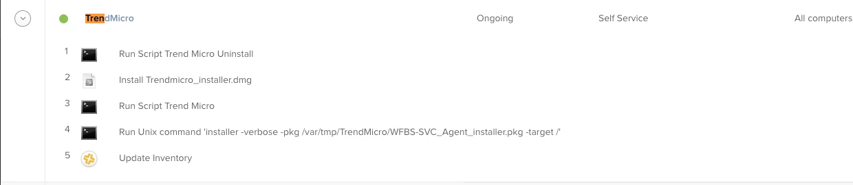

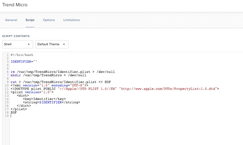

@mack525 Toss me you a screen shot of you your Uninstaller script as well so I can save it for the future.
  • April 18, 2019
  • April 19, 2019
@mack525 The Uninstaller script works flawlessly.
However the installation portion of it still fails to complete. (No ERRORS) && No Trend Icon or Application in site.
IDENTIFIER="pulled from trend"
rm /var/tmp/TrendMicro/Identifier.plist > /dev/null
mkdir /var/tmp/TrendMicro > /dev/null
cat > /var/tmp/TrendMicro/Identifier.plist << EOF
<plist version="1.0">
   <dict>
      <key>Identifier</key>
      <string>Your Identifier</string>
   </dict>
</plist>
EOF
Details
Executing Policy WFBS TrenMicro Installation
Downloading https://use1-jcds.services.jamfcloud.com//download/19727f945eb74fb797d9d257fa52498e/TrendMicro.dmg?token=downloadsatoken
Verifying DMG...
Verifying package integrity...
Installing TrendMicro.dmg...
Closing package...
Running script TrendMicro Installation...
Script exit code: 0
Script result: rm: /var/tmp/TrendMicro/Identifier.plist: No such file or directory
mkdir: /var/tmp/TrendMicro: File exists
Running command installer -verbose -pkg /var/tmp/TrendMicro/WFBS-SVC_Agent_installer.pkg -target /...
Result of command:
installer: Package name is Trend Micro Security Agent
installer: Upgrading at base path /
installer: Preparing for installation….....
installer: Preparing the disk….....
installer: Preparing Trend Micro Security Agent….....
installer: Waiting for other installations to complete….....
installer: Configuring the installation….....
installer:
installer: Writing files….....
installer: Running package scripts….....
installer: Validating packages….....
installer: The upgrade failed (The Installer encountered an error that caused the installation to fail. Contact the software manufacturer for assistance.)

I feel like this may have something to do with the permissions the Agent is trying to run off, of even though I followed your instructions and set the user to root (0) & Group to Admin (80) Read and Write. I feel like it's trying to execute at the hidden private folder and throwing an Error I cant see first hand on the back end.
How do you have your permissions setup during creation at composer. Is it all root/admin from the top at the Private folder lvl or just at the Execution of the package?
