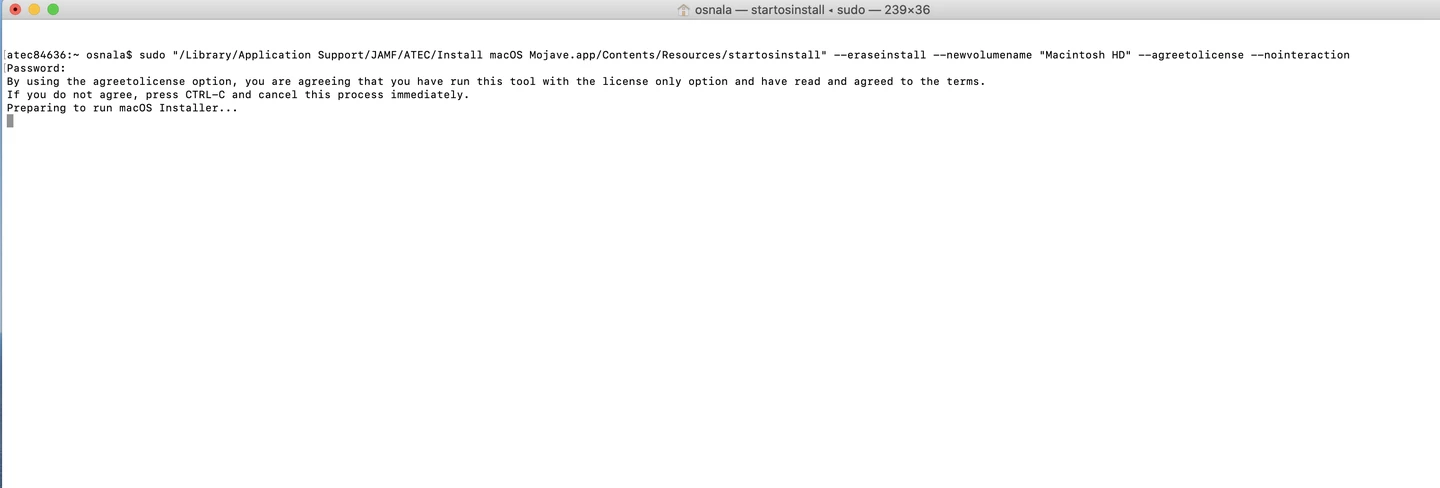

Has anyone tried or has luck with downgrading Catalina to Mojave using the startosinstall command? My reason for downgrade is we are expecting an order of 100+ machines which will come with Catalina installed and our existing enviroment and software runs on Mojave due to some of the software vendors not supporting Catalina yet. So we must downgrade until we are ready to move to Catalina.
I've tried running the command but via policy calling the installer but it just sits there. I've tried running it manually in terminal and same result but shows "Preparing to run macOS Installer..."

The problem you're going to run into is that Catalina splits the APFS container into two volumes. I was playing around with this on Friday using MDS. I haven't tried using the macOS Mojave installer to do this.
With MDS I had to boot into the original OS recovery (Shift-Option-Command-R), use Disk Utility to unmount the volumes, erase the actual drive to GUID with a JHFS+ volume, and then use MDS to re-install Mojave. It's worked fine to do the downgrade, now it's just a matter of documenting it.
  • October 14, 2019
@stevewood Thanks for the info, that totally make sense now about the two containers. I've been able to do the Shift-Option-Command-R route, but was just reinstalling the OS through the internet with whatever OS the computer originally came with then upgrade to Mojave. Your process takes that extra step away, now just gotta figure out a way to automate as much of the process as I can.
  • October 14, 2019
I couldn't get startosinstall to ever work back to an older OS.. 14 to 13 and 14 to 15 betas..
