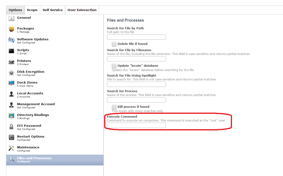

  • December 13, 2016
@nkalister : I realize I'm replying to a 3+ year old post, but I have a question about this:
you don't even need to make it into a script- you could just create a policy that has your command in the the 'run command' field- that's on the advanced tab of your policy edit screen.
I have a single-line command that I was going to deploy as a shell script, until I saw what you wrote.
Problem is, I can't find the "run command" anywhere. Is it gone? Moved?
SJK (Casper JAMF newbie)
Brad_G
  • December 13, 2016
In your policy choose "Files and Processes" in the left pane. Put your command in the "Execute Command" field and you're set.
  • December 13, 2016
@nkalister In the latest JAMF versions is under the Options Tab -> Files and Processes -> Execute Command, after you start/edit a Policy.
  • December 14, 2016
@Brad_G, @ChickenDenders, and @millersc: Thank you all. Great screenshot, ChickenDenders!
