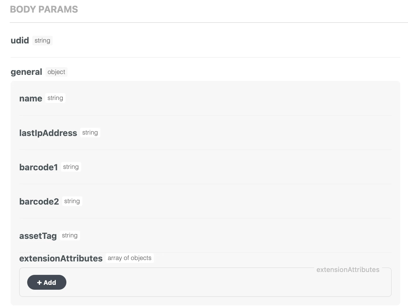

Since I continue to explore the UAPI :). do you know by any chance if PATCHing computer name on JSS is not available yet as well?
As I get 404 error when trying to do it:
curl --request PATCH \\ --url "https://jss.MYCOMPANY.com:8443/uapi/v1/computers-inventory-detail/$id" \\ --header "Accept: application/json" \\ --header "Authorization: Bearer $token" \\ --header "Content-Type: application/json" \\ --data ' { "general": { "name" : "'$computernameinput'" } } '
Yes, updating the name is supported. Make sure to check the center column of the documentation to determine what inputs are allowed by the endpoint you're referencing. The right column, which you included a screenshot of provides an example of a successful response (not the request). I've included a screenshot for reference, which shows that "name" is a supported element in the request body:
The following format is a valid request body:
{ "general": { "name": "NewDeviceName" } }
Finally, the error you're getting seems to be unrelated to the request body. 404 means that the server couldn't find the resource that you specified, in this case, the device ID. Make sure the variable you're using is set properly and/or being passed properly. If you're not super familiar with an API operation or the coding language, it's generally a good idea to ensure the code you're writing works first with hardcoded values, then work backwards to make it scalable/reusable, by substituting in the variables.

You are the best 🙂
404 means that the server couldn't find the resource that you specified, in this case, the device ID - that was the case, I had a miss-type for the JSS URL so it couldn't locate the actual ID, I guess I misinterpreted the 404 error, once I set the correct JSS URL it worked like a charm. Thank You!
