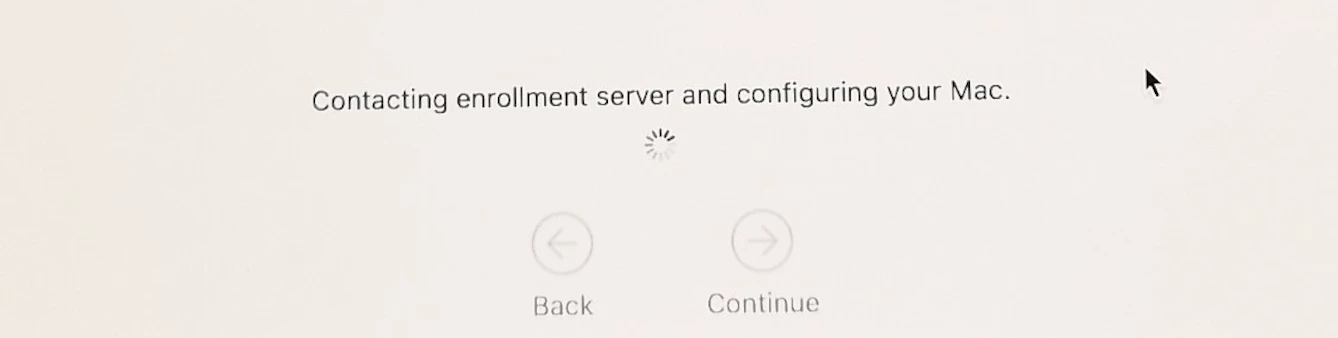

Unable to Connect to the MDM Server for your Organization

I am also seeing this same issue. We just made the switch to JAMF and not a promising start....
  • Jul 23, 2018 7:00 PM UTC
This may be in relation to an open product issue with Jamf (PI-002379) which generates excess DeviceInfoAccountHash, DeviceInfoITunesActive, and ProfileList MDM commands. When these build up, MDM seems to slow down and DEP also seems affected. I would reach out to your TAM/Jamf support to see if you can confirm that you are experiencing this PI. They have a temporary fix for it until they address the issue in product.
  • Aug 7, 2018 5:38 PM UTC
Restarting DNS services did the trick for us
  • Aug 7, 2018 8:41 PM UTC
I do not know what is causing this but I do know how I was able to fix it for the systems experiencing it in my organization. I took their serial numbers and searched in "Devices" (where iOS devices would go) and found that they were all in there with the name: [No Name] After I deleted these entries and reinstalled a fresh copy of MacOS on each system they connected via DEP without issue.
I ought to follow up on this for posterity...
Turns out that the 34011 error relates to the device being able to contact DEP servers (iprofile/albert), but not being able to reach the CRL servers (.symcb.com, .symcd.com) in order to validate that the certificate being presented to by the DEP servers has not been revoked.
  • Oct 19, 2018 11:11 PM UTC
Anyone has a good fix for this? My instance intermittently gets bug down with this issue. I would get this issue for a few days and suddenly, it would start working again.
anverhousseini
I had the same issue on different servers:
1. Check the Jamf Pro URL in the settings
2. Check the Organization Name (don‘t use special characters like „ä“)
  • Oct 22, 2018 6:27 AM UTC
We had exactly the same issue.
Turned out to be a policy scoped to a (static) group that did not existed anymore.
Jamf is going to fix this is in the new update.
We fixed it by re-creating the missing groups.
  • Jan 24, 2019 2:47 PM UTC
If you still having issues, then go to the deploy wsite, download the token and upload it back to the JSS..
done!
  • Feb 22, 2019 4:25 PM UTC
Hi all need your help on below error while i am trying to register my iMc to DEP
We have allowed 17.0.0.0 subnet with port allow ports 80, 5223, 2195, 2196, 443
  • Feb 22, 2019 5:02 PM UTC
We were recently having issues with apps not installing in iOS and in particular the Native apps at activation Apple has updated this document:
https://support.apple.com/en-us/HT201999
Our fix was to whitelist: bag.itunes.apple.com
Since we did this I am also not seeing the random messages on my prestages saying they cannot connect
  • Feb 27, 2019 7:59 PM UTC
We have the exact problem at the moment. svc-sbdjamfadmin Did you find any proper solution?
kevin_v
  • Sep 17, 2020 6:34 PM UTC
We are still having enrollment failures. This seems to be the only source of knowledge on the matter
https://nstrauss.github.io/mitigating-mac-enrollment-failures/
  • Dec 22, 2021 4:12 AM UTC
We had the same issue and I flushed DNS cache on the client machine which fixed it.
Big sur:  sudo dscacheutil -flushcache; sudo killall -HUP mDNSResponder
