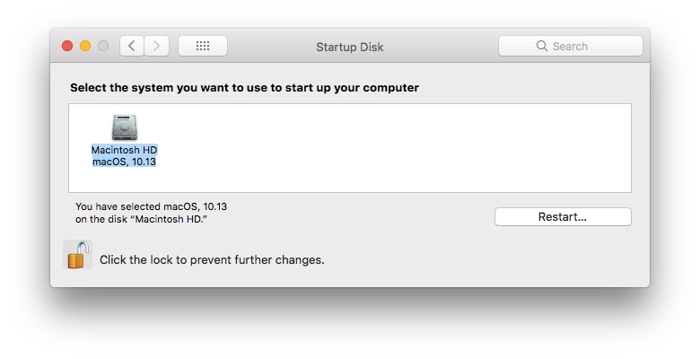

System Preferences >> Start-up disk >> Target disk mode button is missing too!

Ok, well that rules out a newer model being the problem. A 2014 MBA should have no trouble TDM booting that I'm aware of. That leaves 10.13 as a possible culprit. Is the OS on it really just at 10.13, as shown in the screenshot? If so, can you try upgrading it to 10.13.3 to see if that helps? It might be a bug in early 10.13 that you're running into, but that's just a wild guess.
  • March 1, 2018
I first noticed this on 10.12.6
Tried updating it to 10.13 then 10.13.3 without luck. hmm....
