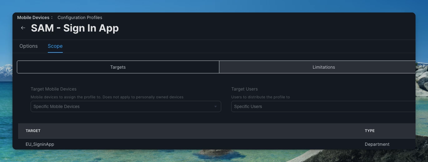

I am wanting to utilise SAM to lock down our iPads to a specific app. Trying to scope this through a department group but the device isn’t showing in the logs for the configuration profile. There are devices in there, just not the two that I specifically need. Both devices that aren’t showing in the logs are supervised and managed institutionally so unsure on what the issue is here… I have also checked to see if I can manually add the two devices but they are not showing when I try to search for them? Getting increasingly confused as the devices that are showing scoped currently, and are in the profiles logs, are NOT supervised...

So - no exclusions or limitations are in place on the config profile.

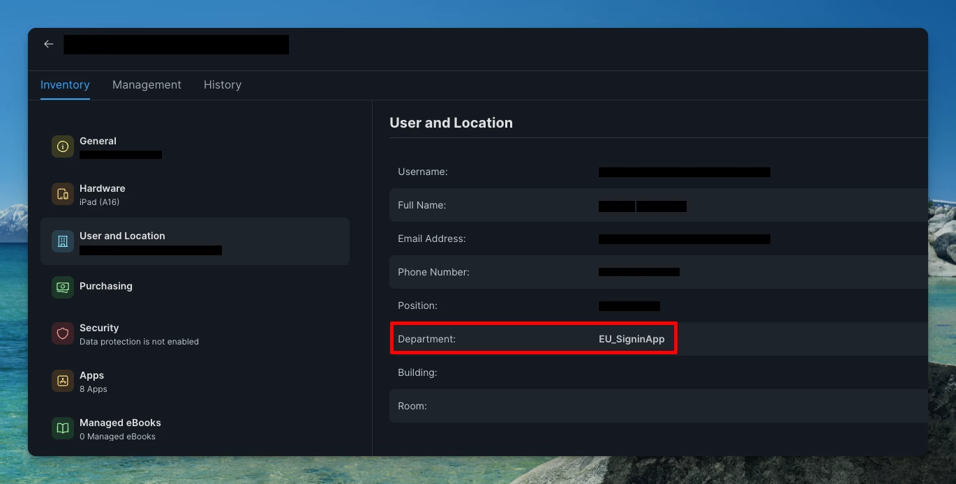

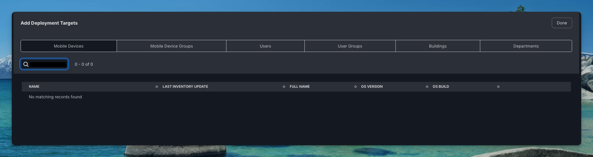

Here is what i see when trying to manually add the host to the scope:
Screenshot of host department:
One thing I have noticed is that the manual assignment screen only provides 26 devices for assignment instead of the 45 we have enrolled in Jamf. I have just created a new static device group and that is not showing in the scope assignment either? I am completely baffled...

Wow… I am silly. The config profile was scoped to EMEA site region instead of global policy. Resolved!
Chubs
  • Sep 18, 2025 2:26 PM UTC
Wait, you get zero results when clicking on Add and “mobile devices”?  What if you recreate the configuration profile + payload?
