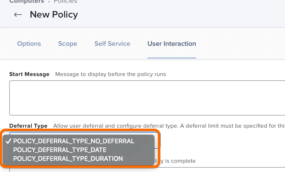

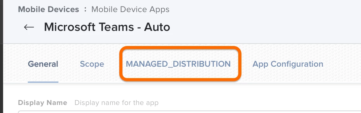

We have on-premise Jamf Pro instance. Updated to 10.21.0 and running MySQL 8.0. Starting to notice that some menus in Jamf Pro is showing up with underscore and all Caps like it's straight out of how database would show. Maybe if you look at the image, you can see what I'm talking about.
Is this issue with 10.21.0? Or Is it just my instance?

Seen this before, try flushing your browsers cache before contacting hand support
  • May 21, 2020
It seems that it haven't been translated. Unfortunately can't test from my side as I have 10.20.
mm2270
  • May 21, 2020
It’s a browser cache issue like @Cayde-6 mentioned. It only happens (in cases I’ve seen) after an upgrade like you described.
Flush your browser cache or try a different browser than the one you normally use to access your Jamf console and things should show up correctly.
