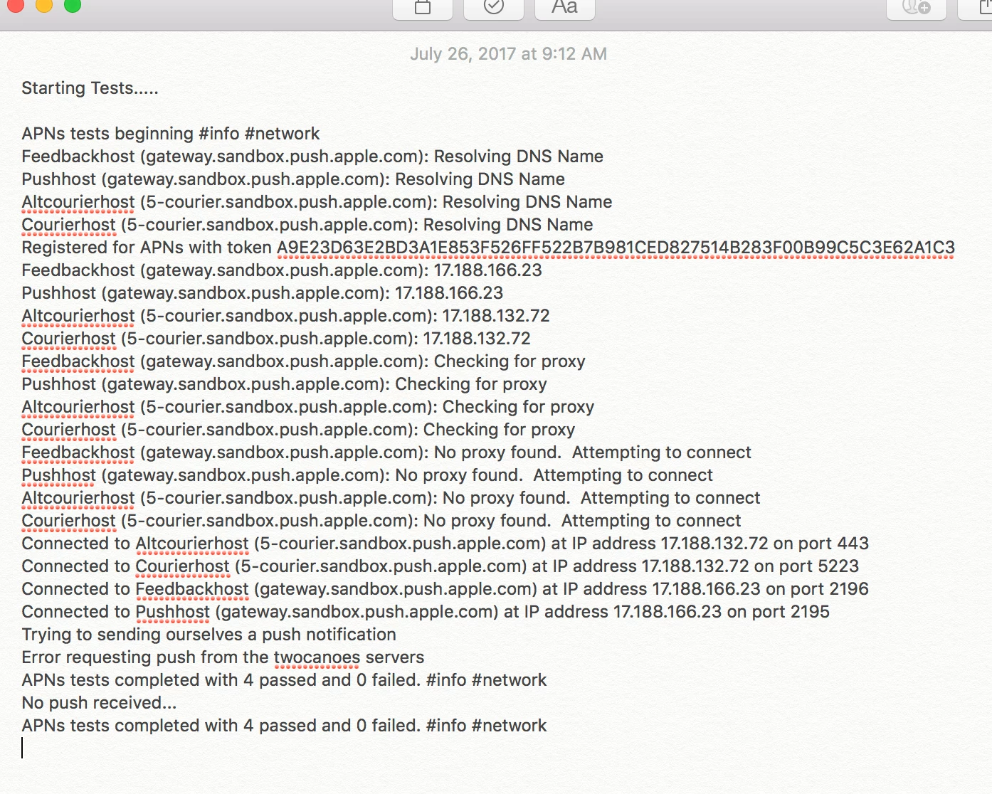

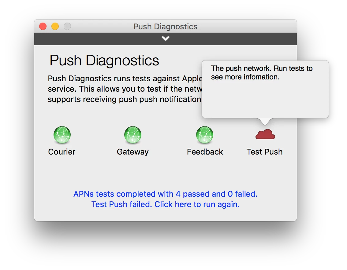

@tperfitt - is the app still functional? when I test, it says failed on the test push from the twocannoes servers.
Starting Tests..... APNs tests beginning #info #network Feedbackhost (gateway.sandbox.push.apple.com): Resolving DNS Name Pushhost (gateway.sandbox.push.apple.com): Resolving DNS Name Altcourierhost (5-courier.sandbox.push.apple.com): Resolving DNS Name Courierhost (5-courier.sandbox.push.apple.com): Resolving DNS Name Altcourierhost (5-courier.sandbox.push.apple.com): 17.110.226.165 Pushhost (gateway.sandbox.push.apple.com): 17.172.232.45 Feedbackhost (gateway.sandbox.push.apple.com): 17.172.232.45 Courierhost (5-courier.sandbox.push.apple.com): 17.110.226.165 Altcourierhost (5-courier.sandbox.push.apple.com): Checking for proxy Pushhost (gateway.sandbox.push.apple.com): Checking for proxy Feedbackhost (gateway.sandbox.push.apple.com): Checking for proxy Courierhost (5-courier.sandbox.push.apple.com): Checking for proxy Altcourierhost (5-courier.sandbox.push.apple.com): No proxy found. Attempting to connect Pushhost (gateway.sandbox.push.apple.com): No proxy found. Attempting to connect Feedbackhost (gateway.sandbox.push.apple.com): No proxy found. Attempting to connect Courierhost (5-courier.sandbox.push.apple.com): No proxy found. Attempting to connect Registered for APNs with token E...BB Connected to Pushhost (gateway.sandbox.push.apple.com) at IP address 17.172.232.45 on port 2195 Connected to Feedbackhost (gateway.sandbox.push.apple.com) at IP address 17.172.232.45 on port 2196 Connected to Altcourierhost (5-courier.sandbox.push.apple.com) at IP address 17.110.226.165 on port 443 Connected to Courierhost (5-courier.sandbox.push.apple.com) at IP address 17.110.226.165 on port 5223 Trying to sending ourselves a push notification Sent Push....Waiting for a response No push received... APNs tests completed with 4 passed and 0 failed. #info #network
oh, and the completion message is in error, it shows failed, but your results say all passed.

This may have been a casualty of the migration from Urban Airship to Amazon for APNS. Thanks for letting me know. I'll look into it.
tim
I spoke too soon. I just tried for me and it worked fine for both the test and production servers. Send me the push token and I can investigate further. Send it to support@twocanoes.com.
tim

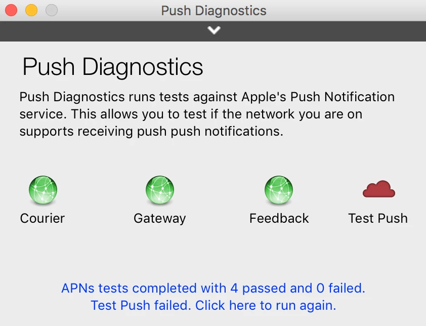

im having issues with the push diagnostics page as well, any help?
Same issue here, someone can help me with it?, this only happens on just 1 DEP Mac.
I don't see any indication that with the latest version (3.2) it does any test push. Just DNS and connectivity checks. That's great, but it assumes that the infra on the Apple side is working. This is not sufficient when trying to crack into an actual problem.
I've emailed twocanoes.

Gs.Apple.Com (gs.apple.com): No proxy found.  Attempting to connect
Gs.Apple.Com (gs.apple.com): Checking for proxy
Swdownload.Apple.Com (swdownload.apple.com): Checking for proxy
Swdownload.Apple.Com (swdownload.apple.com): No proxy found.  Attempting to connect
Swscan.Apple.Com (swscan.apple.com): Checking for proxy
Skl.Apple.Com (skl.apple.com): Checking for proxy
Swscan.Apple.Com (swscan.apple.com): No proxy found.  Attempting to connect
Skl.Apple.Com (skl.apple.com): No proxy found.  Attempting to connect
Iprofiles.Apple.Com (iprofiles.apple.com): Checking for proxy
Gnf-Mr.Apple.Com (gnf-mr.apple.com): Checking for proxy
Ig.Apple.Com (ig.apple.com): Checking for proxy
Ns.Itunes.Apple.Com (ns.itunes.apple.com): Checking for proxy
Deviceenrollment.Apple.Com (deviceenrollment.apple.com): Checking for proxy
Mdmenrollment.Apple.Com (mdmenrollment.apple.com): Checking for proxy
Deviceservices-External.Apple.Com (deviceservices-external.apple.com): Checking for proxy
Humb.Apple.Com (humb.apple.com): Checking for proxy
Swpost.Apple.Com (swpost.apple.com): Checking for proxy
Iprofiles.Apple.Com (iprofiles.apple.com): No proxy found.  Attempting to connect
Gnf-Mr.Apple.Com (gnf-mr.apple.com): No proxy found.  Attempting to connect
Ig.Apple.Com (ig.apple.com): No proxy found.  Attempting to connect
Ns.Itunes.Apple.Com (ns.itunes.apple.com): No proxy found.  Attempting to connect
Deviceenrollment.Apple.Com (deviceenrollment.apple.com): No proxy found.  Attempting to connect
Mdmenrollment.Apple.Com (mdmenrollment.apple.com): No proxy found.  Attempting to connect
Deviceservices-External.Apple.Com (deviceservices-external.apple.com): No proxy found.  Attempting to connect
Humb.Apple.Com (humb.apple.com): No proxy found.  Attempting to connect
Swpost.Apple.Com (swpost.apple.com): No proxy found.  Attempting to connect
Static.Ips.Apple.Com (static.ips.apple.com): Checking for proxy
Ppq.Apple.Com (ppq.apple.com): Checking for proxy
Static.Ips.Apple.Com (static.ips.apple.com): No proxy found.  Attempting to connect
Ppq.Apple.Com (ppq.apple.com): No proxy found.  Attempting to connect
Lcdn-Registration.Apple.Com (lcdn-registration.apple.com): Checking for proxy
Lcdn-Registration.Apple.Com (lcdn-registration.apple.com): No proxy found.  Attempting to connect
Oscdn.Apple.Com (oscdn.apple.com): Checking for proxy
Oscdn.Apple.Com (oscdn.apple.com): No proxy found.  Attempting to connect
Ocsp.Verisign.Net (ocsp.verisign.net): Checking for proxy
Ocsp.Verisign.Net (ocsp.verisign.net): No proxy found.  Attempting to connect
Appldnld.Apple.Com (appldnld.apple.com): Checking for proxy
Appldnld.Apple.Com (appldnld.apple.com): No proxy found.  Attempting to connect
Gateway.Sandbox.Push.Apple.Com (gateway.sandbox.push.apple.com): Checking for proxy
Gateway.Sandbox.Push.Apple.Com (gateway.sandbox.push.apple.com): No proxy found.  Attempting to connect
APNs tests completed with 63 passed and 0 failed. #info #network
Confirmation back from Twocanoes. It no longer sends out a test push. The author didn't have enough people interested in paying for the product to maintain the certificate updates.
