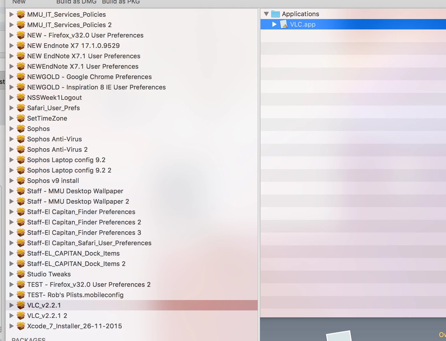

Our current VLC package that we created with Composer also contains all the default user settings etcetera that we set up. Now that there is a new version to patch the Sparkle vulnerability, is there a way for us to somehow update our existing package with the new version (while not affecting the settings), or do we have to go through the entire process of reimaging a Mac with a clean OS and then creating a whole new package from scratch?

You can just add the package back into compose, Then 'convert to source'
At this point, You can just delete the old VLC version from the 'Tree' then drag the new version into the same area in Composer, then Re-Package.
If you keep the same name, when you drag it back into Casper Admin, the original links to 'groups / polices etc' will remain in place..
