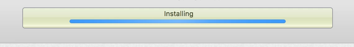

DBrowning
  • April 27, 2016
@eandrade mine is happening on Mac OS. I look in Applications to see if it attempts to install but i just get the attached image.
I see nothing in jamf.log or JAMFApplications.log
