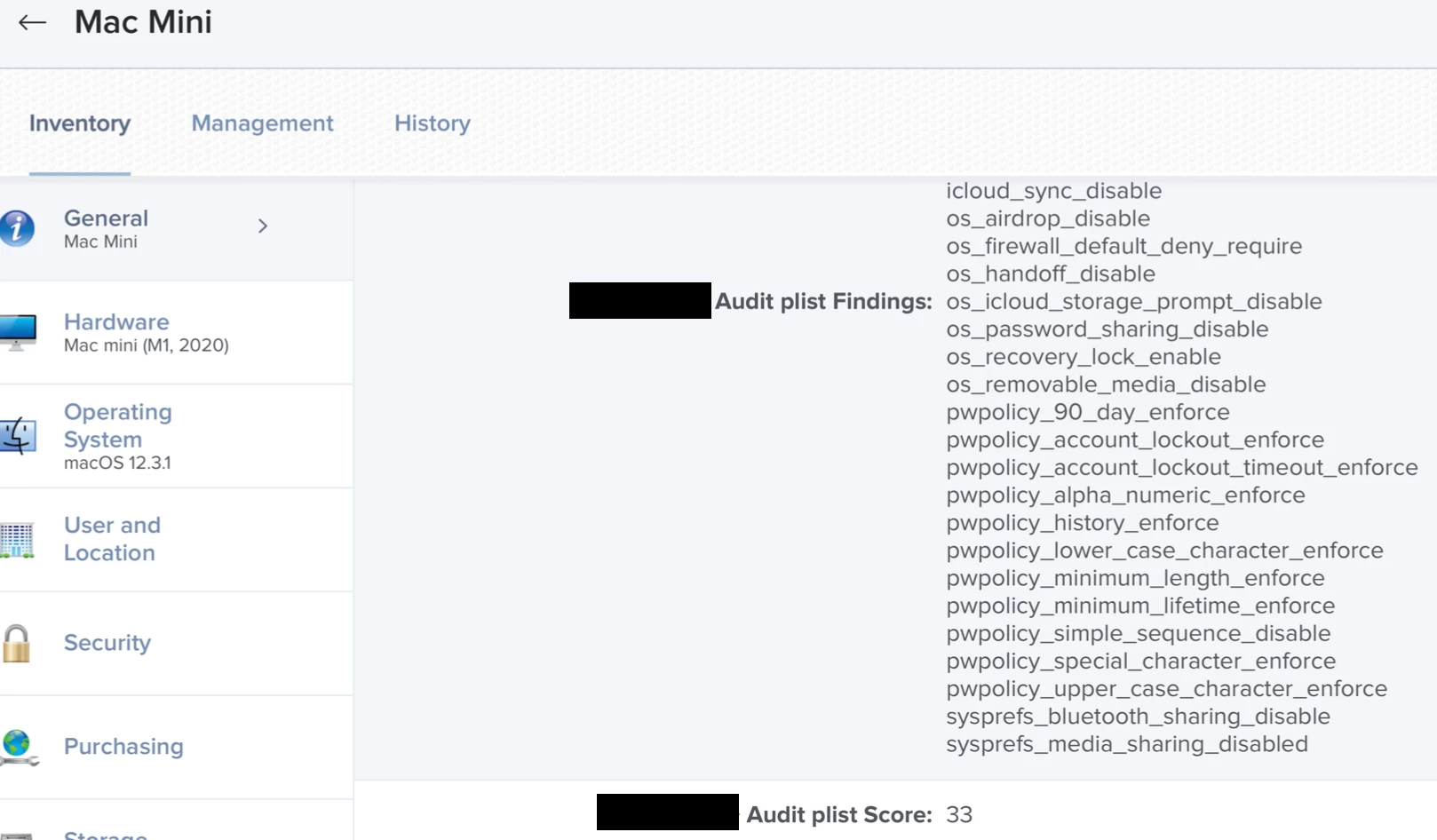

You'll likely need to build the EAs yourself to pull the data out of the generated csv. This will give you your compliant/not compliant items per your image.
