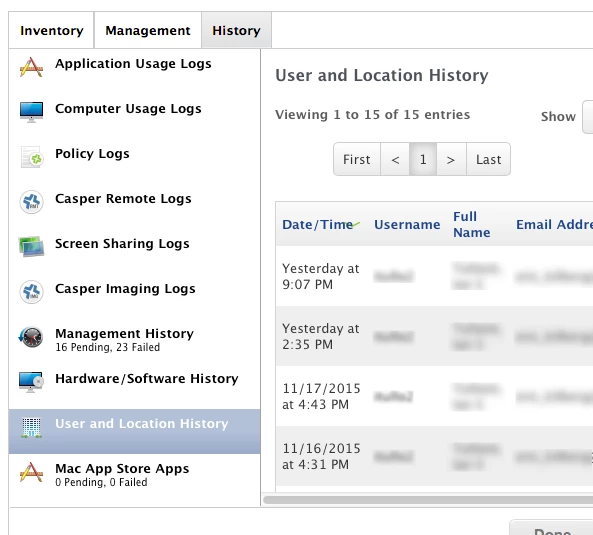

Having some trouble confirming whether this is possible or not:
Is there a way (maybe by flushing a particular log in the Log Flushing section on the JSS) to periodically purge the records in this section for computer objects on the JSS? It seems to me that these never get purged or I am having some sort of issue doing so.
If it is managed by the Log Flushing, which particular log is it tied to?
Thanks in advance!

I can't see that anywhere in the log flushing section. Is it just part of the computer record?
Would be an API call to clear it out if it is in the computer record.
  • November 20, 2015
@davidacland Yes, the User and Location History section in the History tab:
