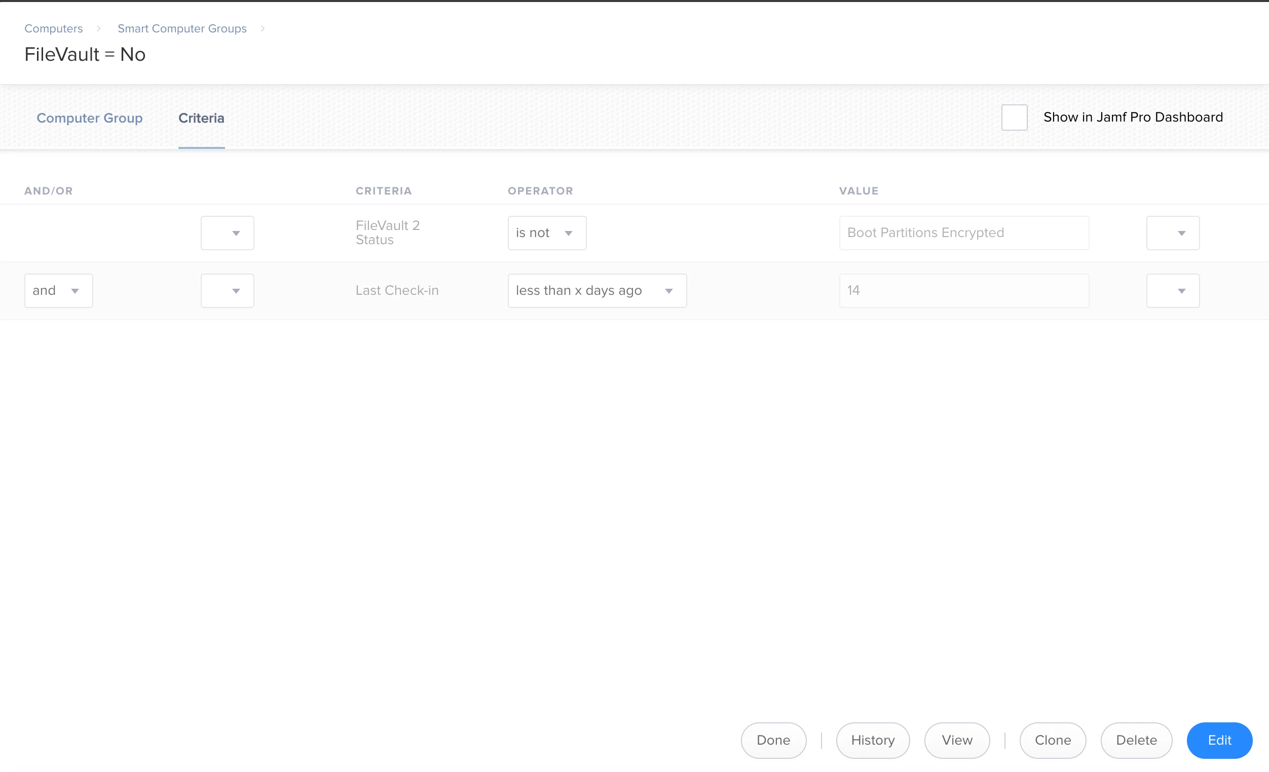

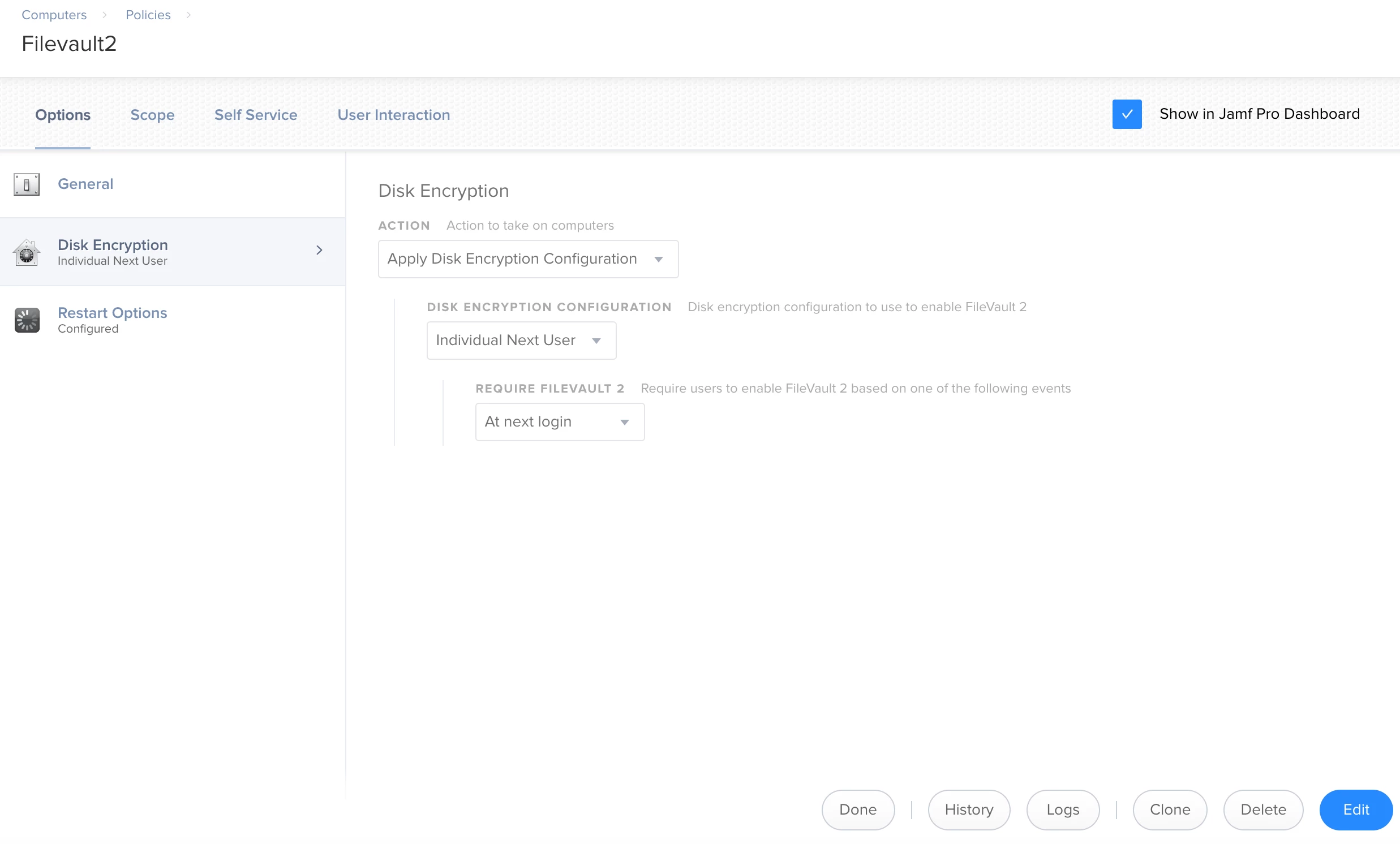

This is how we have FileVault enforced in our environment:
1. We create a Smart Group, labeled "FileVault = No" Criteria:
2. A policy is created to enable FileVault on a machine:
- Scoped out to Smart Group FileVault = No
- Triggered at recurring check-in, Once every day
When a computer meets the Criteria of "FileVault = No" a computer is moved into that Smart Group and the Policy is triggered up to (1) times that day.
Hopefully this helps you!
