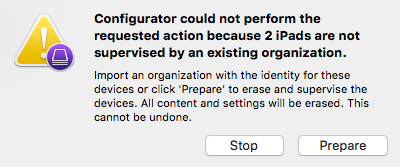

Using automatic enrollment is also causing problems when trying to apply profiles via Apple Configurator 2 because it is supervised by MDM. May require a "company identity" profile that both MDM server and Apple Configurator 2 recognize. Since enrolled through MDM says it is supervised but requires touching device to install when pushed via Configurator 2 using automatic enrollment.

@nhammer1 Were you able to resolve issue? I am seeing the same problem you have
"iPads are not supervised by an existing organisation"
Thanks.
  • October 26, 2015
We have moved forward with a workflow that ignores the automatic setup. We setup the devices manually and then use enrollment profiles near the end of the process. To me it looks like there needs to be a JSS update to use the automatic enrollment in Configurator 2.
