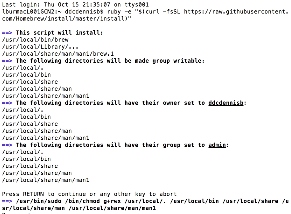

With HomeBrew it tells users to chown the /usr/local/bin and /usr/local/share folders so that it can work. This hasn't been an issue until about a month ago. just happens that I upgraded my JSS to 9.81 a little over a month ago. So either Apple is getting sneaky and starting to change the permission back after OS upgrades or something else is going on.

DBrowning
  • November 1, 2015
@thoule i've attached the screenshot from when first installing homebrew. it shows that just to install the software it will change ownership of the folders.

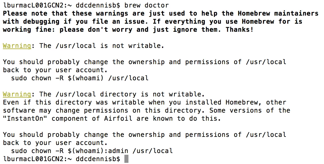

if users are having issues with homebrew running, they run the command "brew doctor" and are given the following messages:

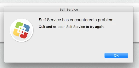

Forum|alt.badge.img+15
  • November 2, 2015
@ddcdennisb That's hilarious! "sudo is dangerous. don't use it. Instead give ownership of all system directories to homebrew to modify directly without sudo because clearly that's safe!" Yeah- no more homebrew in my office.
mm2270
  • November 2, 2015
The missing piece to the above FAQ-
So instead of using sudo, we'll have you modify the permissions on folders created by the OS and make you the owner, creating a security risk in the process (and only to have a repair permissions process put it back the way it should be later).
Yeah, that makes perfect sense. Not sure who wrote that up for homebrew, but they are delusional. Folders created by the OS should not be touched or have permissions modified. That's the entire reason Repair Permissions even exists in OS X, and why Apple effectively put an end to it with El Capitan. (Repair Permissions is MIA in the 10.11 version of Disk Utility you'll notice) Its also why sudo commands exist! So you don't have to change the actual permissions to be able to add items into protected locations. Good grief!
To put this into perspective, making you the owner of /usr/local/ is the equivalent of needing to make you the owner of /Applications/ just because you installed a new application into that folder that didn't come with OS X. Yep, its just as nuts.
FYI..
Homebrew's recommendation to recursively change ownership of /usr/local using the following command breaks jamfAgent which leads to a broken Self Service.
sudo chown -R $(whoami):admin /usr/local
This will fix it
sudo chown -R root:wheel /usr/local/jamf

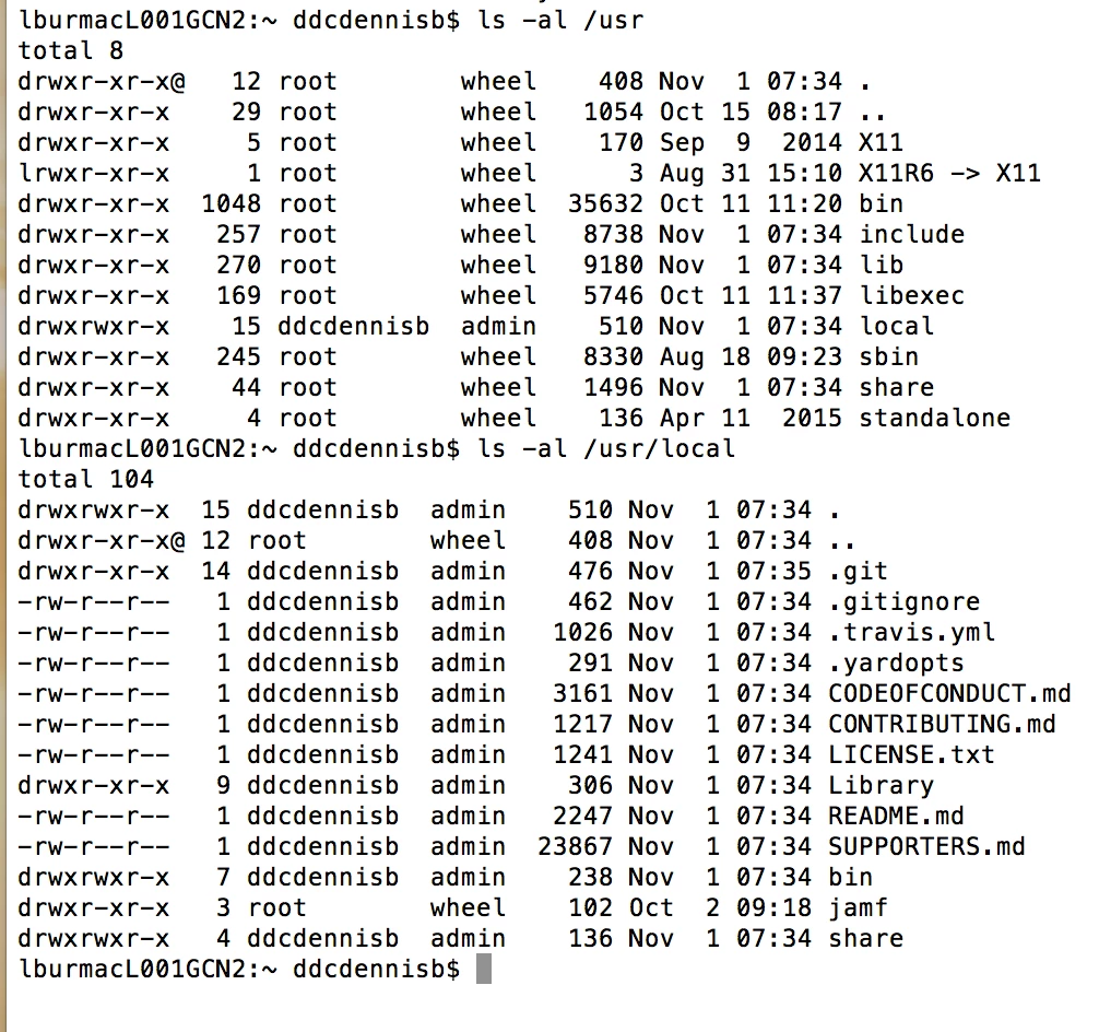

  • November 5, 2015
To add some signal, we've had a few users report this same issue, and it appears to be triggered by Sophos Anti-Virus:
https://community.sophos.com/products/free-antivirus-tools-for-desktops/f/17/t/10029
Sophos says they'll update the client in the next few weeks to stop chown-ing /usr/local. That said, I may start installing Homebrew in a different path so it isn't affected by issues like this down the road, since as others have mentioned, Apple may also opt to reset permissions during future software updates.
