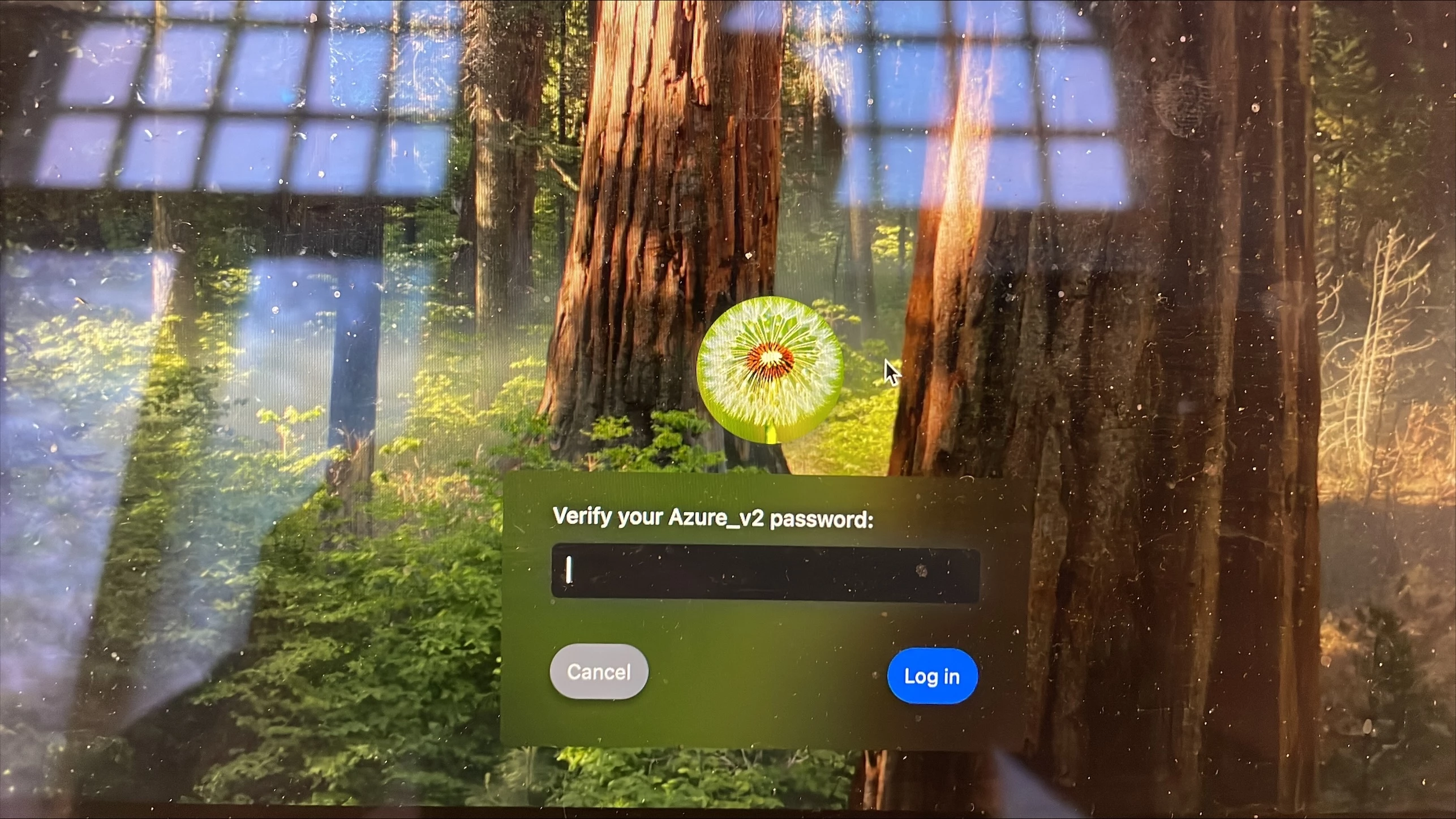

Hey guys. Bare with me, I have taken oven my company's JAMF environment and have now faced some issues.
When logging in to the computer they type in their company email + password then authenticate with MFA. When this is done they face this window "Verify your Azure_V2 password:" and they type in their password and log in. This usually works. But now we have faced issues with user not coming through this step, they are "bounced" back to 365 log in window.
This is something pretty new, maybe something changed in azure - but not sure how to remove this step. We have "Passtrouh authentication with Jamf Connect"

 Seems the picture did not upload, so here it is
  • Apr 22, 2025 10:01 AM UTC
I don't seem to be able to edit my post. But I checked the sign in logs for this specific user and it says. "Success" at first, then "Interrupted" Sign in error code 50076

Thank you for your reply
Here are some logs of the user. I could log in to his computer offline with our Local admin password so we could back up his files - also tried to reset his password to his old password he had before but same issue.
Will also try to exclude MFA from JAMF connect in Azure to see if that helps
