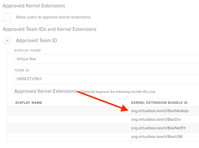

Just tried to install VirtualBox 6.0.12 and ran into the same issue. Turns out they added a new KEXT (org.virtualbox.kext.VBoxNetAdp) that just needed to get loaded into the Configuration Profile and deployed prior to running the install.

I was able to get this to work on Mojave. Here are my packaging tips for anyone else reading this:
  • This application has a kext for Oracle America added to the Approved Kernel Extensions policy.
  • This application does not seem to work at all unless the Extension pack is also installed.
  • When making the package, just open the DMG and copy the pkg to Jamf Admin. The pkg seems to have scripts that are needed for the application to run right. I was seeing some versions (6.0.6 and 6.0.8) failing at the end of running the pkg manually.
  • The uninstall VirtualBox script unloads and removes the kext so I took that out of our policy as I think it was removing the kext.
