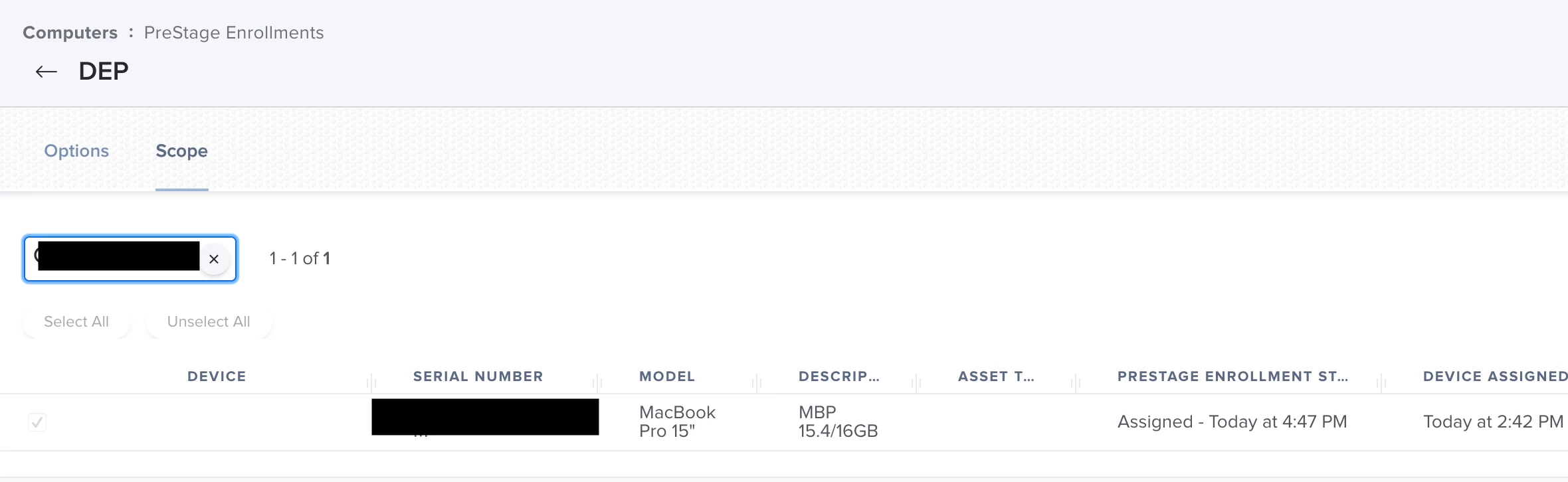

  • April 10, 2020
@sharrington I followed those you steps in the link you posted and still cannot get the Prestage Enrollment to work on initial boot. (it's taking me directly to the "Data & Privacy" screen.) Using VMware Fusion 11.5.3 and the macOS10.15 installer.
The serial number is scoped to a Prestage Enrollment:
And I added the following lines to the .vmx file:
serialNumber.reflectHost = "FALSE" serialNumber = "[MBPSERIALNUMBER]" hw.model.reflectHost = "FALSE" hw.model = "MacBookPro11,5" smbios.reflectHost = "FALSE"
Am I missing anything?
Thanks!

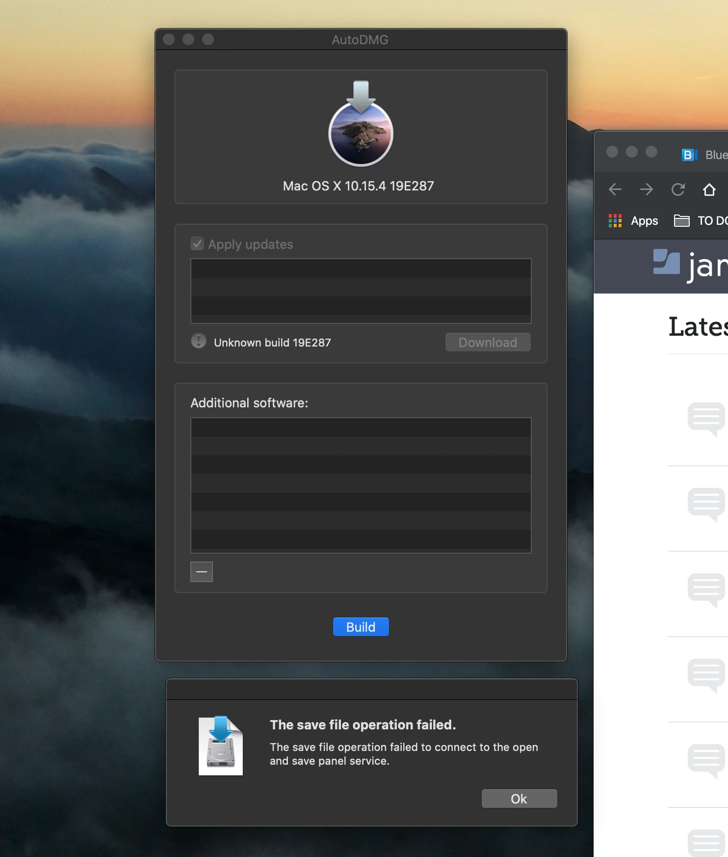

  • April 10, 2020
@ScottSimmons I tried your steps posted but am getting hung up at 2f. I'm getting the following error:
The save file operation failed to connect to the open and save panel service.
See the screenshot below:
FWIW, i'm running macOS 10.15.3

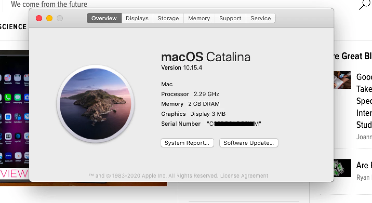

@sharriston I went through the setup options in the VM to take a peep at the Serial Number and model... do the following details in my About This Mac page look weird to you? My Serial Number has the quotes included, and the Mac model isn't populating.
I'm almost certain now it's something in my .vmx file, but I'm using the format I posted previous, so idk.
