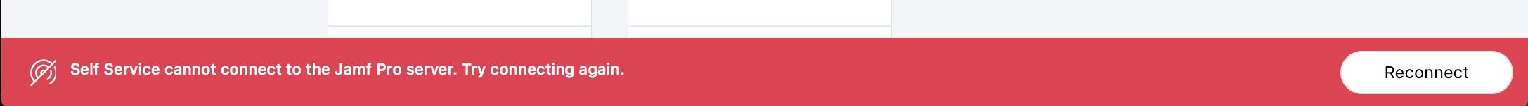

Suddenly I can't pull any VPP apps down via Self Service. On two machines, I get the same result. PKGs I've uploaded appear to work fine, but VPP stuff gives the error in the screenshot. Clicking reconnect gives a DONE and apparently successful checkmark, but it still doesn't work. It will usually throw me out to the App Store, with GET leading to asking for a login. Thoughts?

For these impacted computers, could you try running this command in terminal to verify that your computers are able to hit your Jamf Pro server?
sudo jamf checkJSSConnection
If your computers can properly see your Jamf Pro, it might just be the Self Service app unable to see it, at which time I'd recommend removing the app and re-issuing it out to your computers.
  • January 18, 2018
This worked! I deleted Self Service, then re-added with "sudo jamf policy" and then install then worked without incident.

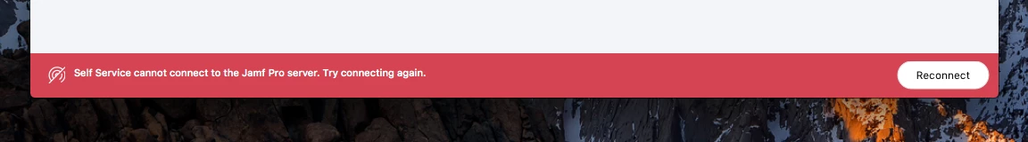

i encountered the same problem with VPP Apps Pages and Keynote. checkJSSConnection is ok. re-adding Self Service doesn´t fix it.
Self Service Notification says:
