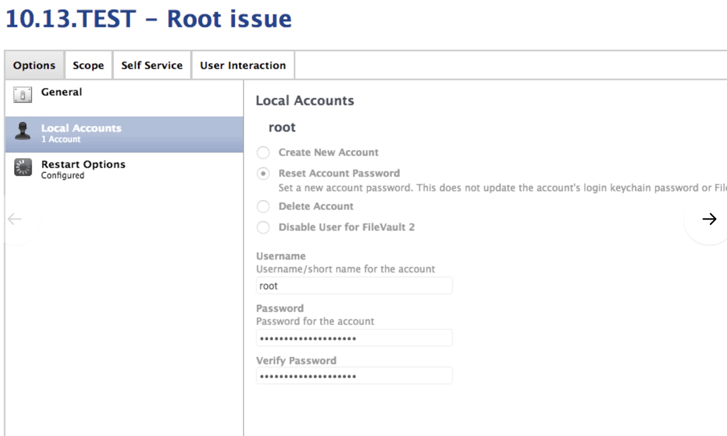

I tested the script from https://derflounder.wordpress.com/2017/11/28/blocking-logins-to-the-root-account-on-macos-high-sierra/ on a few machines and I'm getting this error on some of them - any ideas what it means exactly?
Script result: <dscl_cmd> DS Error: -14165 (eDSAuthPasswordQualityCheckFailed)<br/>passwd: DS error: eDSAuthPasswordQualityCheckFailed<br/>Changing root shell from /usr/local/bin/zsh to /usr/bin/false<br/>
EDIT: Figured it out, changed script to a hardcoded password that will always pass Apple's (TERRIBLE) password complexity rules

I've tried just changing the root password and disabling the account in the GUI and the settings take. However they do not appear to survive restart.
easyedc
  • Nov 29, 2017 12:32 AM UTC
@BostonMac I believe you have to leave the root user enabled with your password. I haven’t tested but think I read that.
  • Nov 29, 2017 12:34 AM UTC
@BostonMac , @easyedc is correct if you do it via gui it's gotta still be enabled.

Be warned. I discovered, and have confirmed on a few sites, that if you disable root the exploit returns. When you set the root password you need to keep the account enabled.

I see a few posts here with scripts to make random passwords for root. Sorry if this sounds stupid but I'd like to make sure there is no reason I would ever need the root password? Luckily we've only had a few users upgrade to High Sierra before it was blocked.
  • Nov 29, 2017 2:49 PM UTC
Why is everyone using scripts when this seems to fix the issue? Using scripts to randomize the password instead of setting a single password for everyone?
  • Nov 29, 2017 2:52 PM UTC
Its difficult to log in to all 16,000 macOS devices.
@jstine I don't want all my devices to share a root password, I want it to be long and randomly generated.
