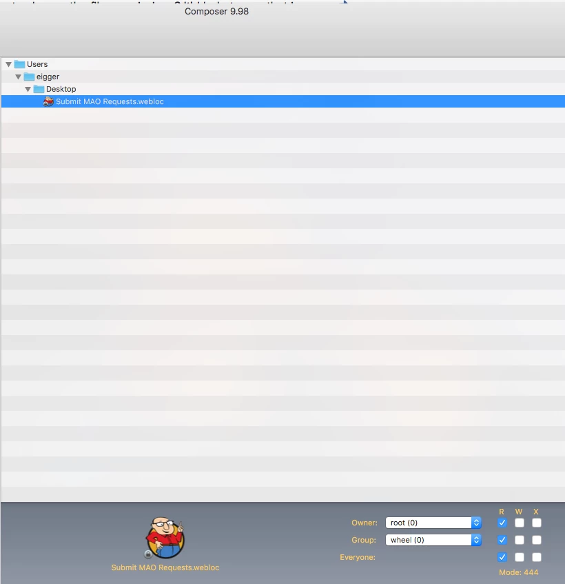

Hi Admins,
I would like to get some guidance on how to properly deploy Webloc Desktop Shortcut / FUT-FEU dmg. I got a very helpful guide from this post. https://www.jamf.com/jamf-nation/discussions/23531/create-shortcut-on-users-desktops-that-cannot-be-deleted#responseChild147521
On my testing computer, it successfully created the Desktop Shortcut using the guide from the post above. I scoped it on my test computer. When I tried to deploy it using ldap group, it corrupts the Library of the logged in user. I receive "macOS needs to repair your Library" error. I would like the shortcuts immutable by changing the permissions, but I think its the changing of the permissions thats causing the error. I created a Self Service plug ins for this shortcuts but our Users just want it on their desktops instead. Thanks in advance.

I used exactly what @mm2270 and @sapalmerBCS posted before dragging them to Composer.
sudo chown root:wheel /Users/john.doe/Desktop/TestShortcut.webloc
sudo chmod 444 /Users/john.doe/Desktop/TestShortcut.webloc
sudo chflags uchg /Users/john.doe/Desktop/TestShortcut.webloc

  • June 12, 2017
As per yourself and @sapalmerBCS 's post. Below is what I did.
I created a webloc on my Desktop
Opened terminal and changed the permissions
cd Desktop/
sudo chown root:wheel "Submit MAO Requests.webloc"
sudo chmod 444 "Submit MAO Requests.webloc"
sudo chflags uchg "Submit MAO Requests.webloc"
Dragged it to Composer and created a dmg
Dragged it to Casper Admin and Checked FUT/FEU
