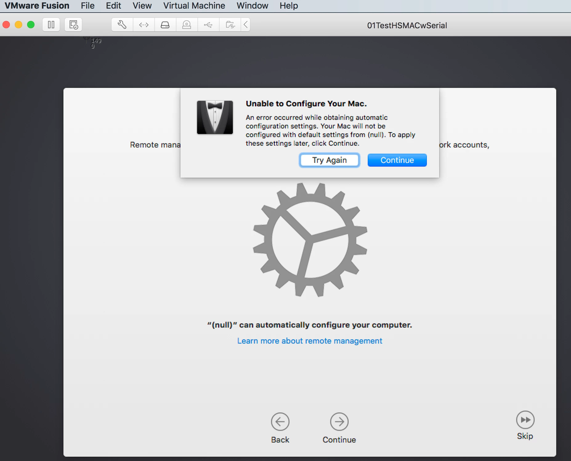

  • February 14, 2018
I tried and got this error
  • June 3, 2020
Does this process still work with Jamf 10.21 and Catalina 10.15.4? I do not trigger Remote Management in a VMware VM, but the physical machine with the same serial does trigger.
sdagley
  • June 3, 2020
@davidi4 The serial numberand model number must be correct, and you have to set them before doing the macOS install on the VM. See this thread for more discussion: Enrolling OSX virtual machine into JSS - Issues
  • June 3, 2020
There is additional information in Traveling Tech Guy's article, following his steps actually worked for me - I believe the addition of the reflectHost = FALSE lines were key:
serialNumber.reflectHost = "FALSE"
serialNumber = "C02NXXXXXXX"
hw.model.reflectHost = "FALSE"
hw.model = "MacXXXXX#,1"
smbios.reflectHost = "FALSE"
https://travellingtechguy.eu/vmware-dep/
