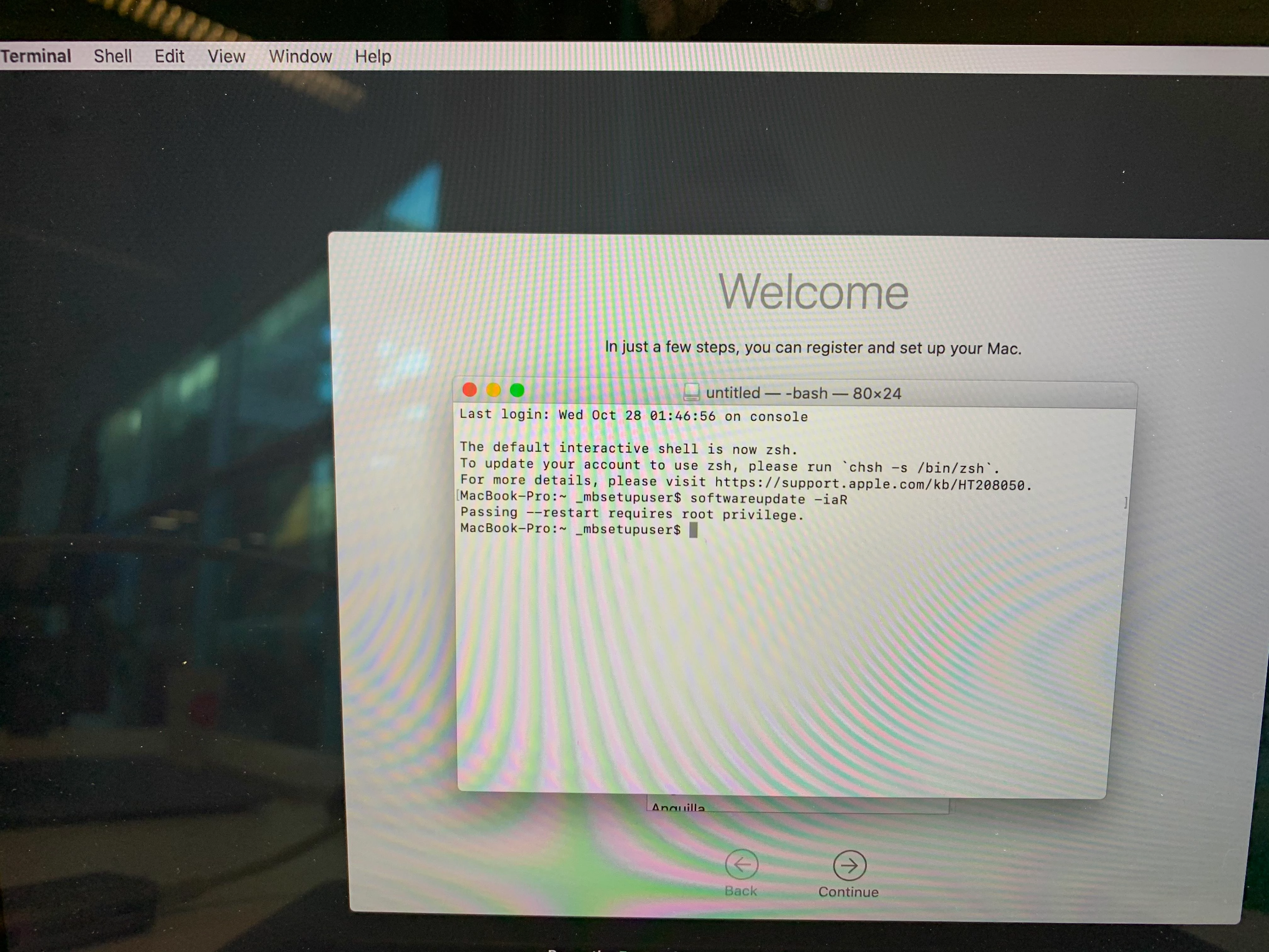

@sdagley running softwareupdate -iaR comes up with:
Passing --restart requires root privilege.
Anyone know the mbsetupuser password? (I jest, no-one knows that* password!)
Just have to shutdown Terminal and the mac setup screen with the usual Cmd-Q buttons :-)

@tsylwest I am running the command suggested by @sdagley right now and it is working, updates are downloading and being installed. Terminal automatically launched as the root user for me. This is straight out the box, booted, and used the keyboard shortcut to launch terminal at the country selection screen (it didn't work on the language selection screen for me). Fingers crossed, I can deal with this minimal interaction before giving devices out.
sdagley
  • October 27, 2020
@tsylwest When you access Terminal from the Setup Assistant with that key sequence you're running as root so the mbsetupuser account doesn't come into play
@JC_CLCSD Glad to hear it's working for you. There's definitely some inconsistencies in the instructions on how to get into Terminal, but my understanding was the Language Chooser was critical to the process so very interesting that's not where you ended up accessing Terminal.

@sdagley that's weird... It dropped me at a normal non-root prompt, it was definitely not a # prompt. I don't think the error I posted would have appeared had I been at a root prompt. Curiouser and curiouser... going to double check it again and will report back :-)

An odd (to me) behavior I've found with terminal access during setup assistant is that the shortcut key sequence to open terminal in 10.15.6 only worked for me on the country selection screen. That does not work for me in 10.15.7, I had to be on the language selection screen as @sdagley stated.

@sdagley seems they (read:Apple) may have changed something...!

@tsylwest That looks like the Country, not Language, selection screen. The root access to Terminal sequence has to be done on the Language selection screen which will normally only appear the very first time a Mac is booted. This page shows how you can make it re-appear: Resetting Device Enrollment cache without reinstalling macOS

@sdagley Thank you so much for that! Root access: granted.
Some more Apple 'mists' have now been cleared, much appreciated.
